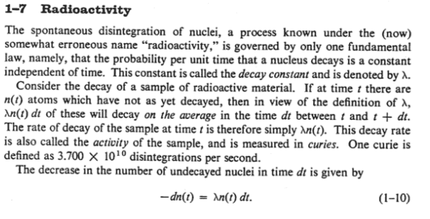

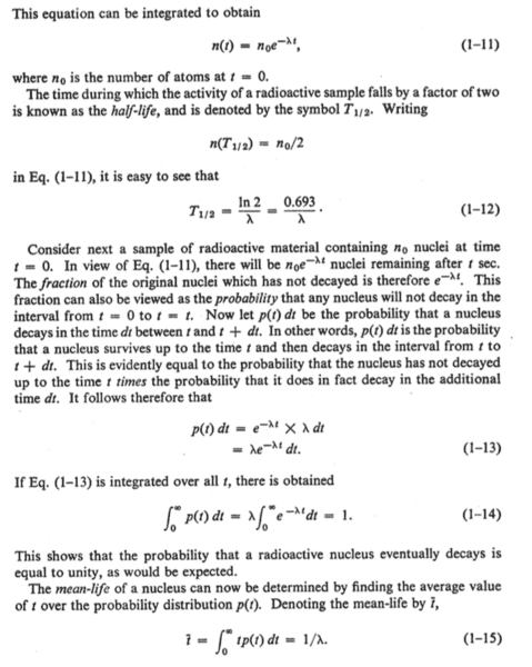

My bad, I was wrong. I think the confusion comes from my wrong use of words.
The law of decay says that "the probability per unit time that a nucleus decay is a constant and that constant is called ##\lambda##". It just says that ##\lambda## is a constant.
The probability that any nucleus will decay is time dependent as you said because it is represented by the ratio ##N/N_0## which is a function of time.
PS: I went back and checked on my book.
Here's some scans from my book. Hope it will help you

Ah, just what I needed- thank you very much

Just what I needed, thank you very much :D
btw is that an undergraduate level textbook, if so- which year is it in (as in 1st or 2nd year of coursework)

This book is more for engineers than (I'm assuming) a physics undergrad. Anyway I'm using it right now in my first year as a grad student
