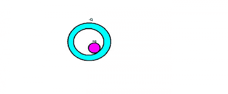

I want to know
charged metal object is placed in contact with
what does it mean?
Does it mean charged metal object is placed inside the shell interior?
Is it correct?
When something is placed in contact with something else it means the two things are touching each other.
You mean conductor touches another conductor's interior?by?How would the setup look like?
It would look like a pair of 3 dimensional bodies as represented in your 2D sketch. Imagine a small metal egg held inside a larger hollow metal shell so that there is air all around the smaller one, insulating it. Then allow the middle one to fall onto the interior surface of the larger one when you want them to contact.

Object in contact with the shell interior:
Likes gracy and Simon Bridge

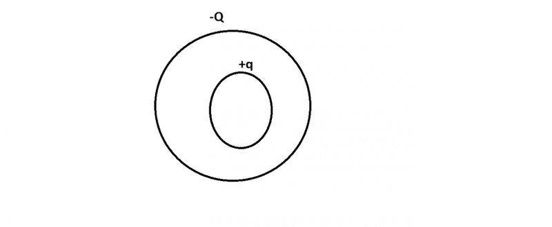

@ehild diagram you drew greatly explained my doubt.
Now ,could you please do one more favor?
Can't we include charges in that particular figure?
Is it right ?
I am not showing that Q>q or any such thing.I am just considering the general case.
Just want to know/confirm location of charges whatever the magnitude may be .
After the conductors have been put in contact in contact with one another, those will no longer be the charges on them.

As I wrote
How can we cancel them?
