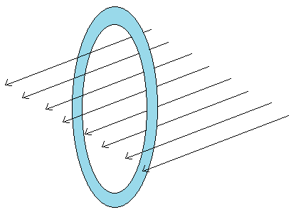

I think my problem is more fundamental than that. So how would you calculate the flux for a straight conductor?
As for the coil, my original post might not have been clear, so I made a quick diagram (attached). The ring represents a coil of wire. From what I understand about magnetic flux, the area used should be the blue shaded area - I don't see how the part inside matters because only the wire is cutting the field.
I am sure this is simply because I don't understand what 'flux' really means, I doubt my textbook would make such a mistake.

… I made a quick diagram (attached). The ring represents a coil of wire. From what I understand about magnetic flux, the area used should be the blue shaded area - I don't see how the part inside matters because only the wire is cutting the field.
the flux looks like zero :confused:

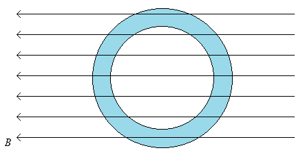

Right, so the wire has to be moved for there to be a 'flux'? Then the flux is simply B times the area of the rectangle 'swept' through?
[...]the flux looks like zero :confused:
Actually... would this case be zero because current in the wire would not be perpendicular to the field?
What about the new case (attached).
that's right :smile:
flux is through an area, not a 1D line …
a moving line sweeps out an area, so we can talk about the flux through that area (usually the rate of change of that flux per time) :wink:
yes
>is there a magnetic flux only when the coil is moved? (I think the answer is "no"?)
>regardless of whether the coil needs to be moved or not, what area do you use?
it's an area (not a 1D line), so there's a flux anyway (moving or not)
you use the whole inside area, and you multiply it by the field
(that's assuming the field is constant … if not, the flux is ∫∫ field dxdy)

This is what I am having trouble with. Is there any way of explaining, in relatively simple terms, why you use that area -- to me it seems like only the wire is 'cutting' the field, so the field lines that do not pass through the physical wire should not be taken into account.
Yes, we only consider uniform constant magnetic fields at A-level.
think "cookie-cutter"! :-p
Ha, that will suffice I think!
Thanks for your assistance, tiny-tim. Much appreciated.
