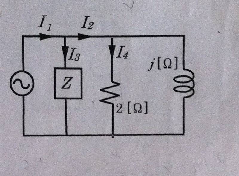

I am still trying to solve this but I first, I need someone to explain to me about the sum of the currents, which I don't understand.
The phasor of current I1 is 2+3j[A], and the phasor of current I2 is 1[A].
1) Find the value of impedance Z.
2) Let the phase difference (arg(I3/I4)) between I3 and I4 be θ. Find the value of tan θ.
Ok, firstly, I am told that I1 = I2 + I3. My question is, what happened to I4?
I2 will split into I4 and whatever current continues on to the inductor (Maybe call it "I5", so that I2 = I4 + I5). Think of the segment labeled with I2 as a wire that connects to the parallel RL pair.
