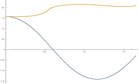

Turns out that a friend that lives close by has had it for ages... I'm now using his computer via TeamViewer :P
I inputted the following, long expression, asking the program to solve the two equations:
EDIT: All of the sines and cosines are capitalised contrary to what's pasted in the spoiler.
s = NDSolve[{θ''[t] + φ'[t]*sin[φ[t]]*[cos[θ[t]]*cos[t] + sin[θ[t]]*sin[t]] + cos[φ[t]]*[θ'[t]*sin[θ[t]]*cos[t] + cos[θ[t]]*sin[t] - θ'[t]*cos[θ[t]]*sin[t] - sin[θ[t]]*cos[t]] == [φ'[t]*sin[φ[t]]*[cos[θ[t]]*cos[t] + sin[θ[t]]*sin[t]] - θ'[t]*cos[φ[t]]*[cos[θ[t]]*sin[t] - sin[θ[t]]*cos[t]]] + [φ'[t]^2]*cos[θ[t]]*sin[θ[t]] - 9.81*sin[θ[t]], φ'[t]*cos[φ[t]]*[sin[θ[t]]*cos[t] - cos[θ[t]]*sin[t]] + sin[φ[t]]*[θ'[t]*cos[θ[t]]*cos[t] - sin[θ[t]]*sin[t] + θ'[t]*sin[θ[t]]*sin[t] - cos[θ[t]]*cos[t]] + φ''[t]*[[sin[θ[t]]]^2] + 2*θ'[t]*φ'[t]*sin[θ[t]]*cos[θ[t]] == [[φ'[t]^2]*cos[φ[t]]*[sin[θ[t]]*cos[t] - cos[θ[t]]*sin[t]] + θ'[t]*φ'[t]*sin[φ[t]]*[cos[θ[t]]*cos[t] + sin[θ[t]]*sin[t]]], θ[0] == θ'[0] == φ[0] == φ'[0] == 0}, {θ, φ}, {t, 100}]
Plot[Evaluate[{θ[t], φ[t]} /. s], {t, 0, 100}, PlotStyle -> Automatic]
But I got the following error:
Syntax::sntxf: "φ'[t]*Sin[φ[t]]*" cannot be followed by "[Cos[θ[t]]*Cos[t]+Sin[θ[t]]*Sin[t]]".
Should I go to the Mathematica forums for this or is it something simple that I'm doing wrong?
Looks like it might be your use of brackets. If you are grouping for multiplication you must use parentheses.
Thank you! It's working now - sort of. It can only be solved accurately for 1.6 seconds... possibly just due to the equations' complexity.
Time t is on the x-axis, angle is on the y-axis, blue is θ, orange is φ, θ(0) = φ(0) = Pi/2, θ'(0) = φ'(0) = 0
Hmm. I don't think there should be an issue with these particular coupled equations. I think I've used Mathematica in the past to do this same thing. Have you tried plotting the solution for a small angle where the small angle approximation would hold? You could compare the numerical solution to the exact solution in that case to make sure they match. When I have a chance today I'll try it myself - don't hold your breath though; its going to be a busy day and then I have company for the weekend.
