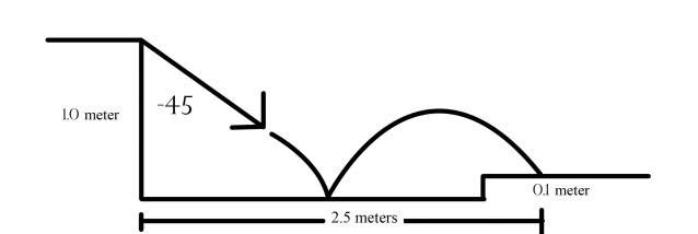

The ball is thrown at -45 from the horizontal from a height of 1 meter. It must bounce and then land 2.5 meters in the x direction at a height of 0.1 meters in the y direction. Find the initial velocity.
I do believe that you're correct about it being a point mass. I know that the angle of incidence and reflection must be the same, however I can't figure out how to get that angle. It seems to me that there are two variables, the initial velocity and the point at which the ball bounces. If I could find where the ball needs to bounce I could solve for the initial velocity. I'm just not sure how to do so.
I was stuck too as it seems like it could have been thrown anywhere along the parabolic arc after leaving the hand. The 1.0 meter height helps big time. It lands at 0.1 meters.

I made a picture to help visualize the problem. Everything you said sounds right except I don't think the final velocity will equal the velocity at the bounce because it doesn't land at the same height.
Well done, except don't you think that the apogee of the arc after the bounce will be higher than the 1.0 meter starting point. It strikes me that at 1.0 meter high after the bounce, the ball will be traveling at Vx upwards and Vx laterally. We don't know the relative displacement at where this occurs, but I think this simplifies the problem but need a few minutes to check on this.
So are you saying that the angle of the bounce will be 45 degrees?

I'm not sure how to solve it as an energy problem? The picture shows all the given information and the problem is to find the initial velocity.

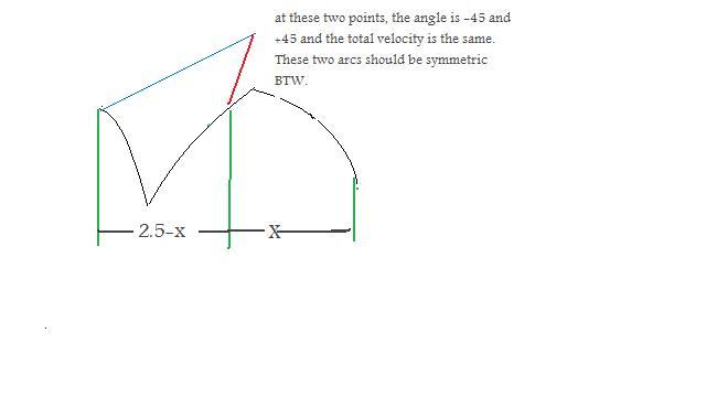

Maybe my crummy drawing will help.
So how do I find x? Once I know that then it's simply the same as the first problem.
I don't think you can find x without using the other piece of the problem, that is the descent and the initial ascent up to the point which is diagrammed. Then you solve simultaneously.
And it may be ugly as both sides of the problem are simultaneous. For an intro class, math shouldn't be that rough--must be something I am not seeing or so dumb math error. Sorry if this has been a wild goose chase,
