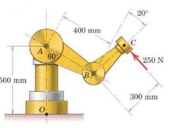

Mechanical diagram of a linkage: a vertical support at O carries a pivot A, with a rod from A to B, then a rod from B to C with a 250 N force arrow at C, dimensions 400 mm, 300 mm, 500 mm, and angles 60 and 20 degrees marked.

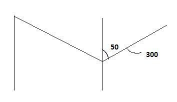

My problem is that I believe I have a wrong concept somewhere, and I can't find what I'm doing wrong exactly. For this problem let's suppose what I want to do is find the rectangular coordinates of BC.
I had two "possible solutions" I tried to achieve this, . First the correct one:
(I apologize by drawing quality)
Diagram of two vertical lines with a line segment from the top of the left line down to the point where the right line meets a sloped segment rising to the right; an angle of 50 degrees is marked at the junction and a length of 300 is labeled along the rising segment.
By determining angles I can find that the angle between the vertical axis and BC is, therefore:
[itex](300\sin(50),300\cos(50))[/itex]
Now the wrong one:
By looking at the original figure alone, first I project BC into AB, then project BC into either X axis or Y axis.
Procedure:
  1. Projecting BC into AB -> [itex](300\sin(20),300\sin(20))[/itex]
  2. Projecting my new AB' into X and Y axis -> [itex]((300\sin(20))\sin(60),(300\sin(20))\cos(60))[/itex]
So, why is my second procedure wrong?
You mean, C in relation to B, yes?
[*]Projecting BC into AB -> [itex](300\sin(20),300\sin(20))[/itex]
I'm not at all sure what you mean by that. Is that supposed to be the coordinates, relative to B, of the projection of C onto the line AB (extrapolated)? If so, it's wrong.

You mean to find the vector from B to C in cartesian coords oriented to the ground/vertical?
i.e. so the +j direction is OA?
##\vec{v}=\overrightarrow{BC} \\ \Rightarrow [\vec{v}]_{OA}= v_x\hat{\imath}+v_y\hat{\jmath} = (v_x,v_y)^t = 300(\sin 50, \cos 50)^t##
(here I'm using ##[\cdots ]_{proj}## to label the projection)
Now the wrong one:
Procedure:
step 1: the angle is wrong.
step 2: each projection of BC to AB needs to be projected onto i/j - so there should be a sum in there.
Redo using unit vector notation and it should be clear.
i.e.
if ##\vec{u}=\overrightarrow{AB}## then the angle between ##\vec{v}## and ##\vec{u}## is 50+60=110deg.
define ##\hat{\jmath}_u = \vec{u}/u## - i.e. it's a unit vector pointing in the same direction as ##\vec{u}##, and let ##\hat{i}_u## to be perpendicular to the right, to make cartesian coords aligned with the y-axis along ##\vec{u}##
then .the projection onto AB goes:.. ##[\vec{v}]_{AB} = \hat{\imath}_u\sin 70 + \hat{\jmath}_u \cos 70##
for step 2, you need to express ##\hat{\imath}_u## and ##\hat{\jmath}_u## in terms of ##\hat{\imath}## and ##\hat{\jmath}##
so that ## [\vec{v}]_{OA} = [\hat{\imath}_u]_{OA}\sin 70 + [\hat{\jmath}_u]_{OA} \cos 70##i.e. ##[\hat{\jmath}_u]_{OA} = \hat{\imath}\sin 60 -\hat{\jmath}\cos 60##
... see what I mean? Each component of the projection onto AB gets another two components.
(caveat: I'm doing this from mobile so I probably made a dumb mistake - the approach should be fine.)

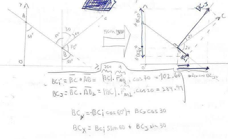

Ok so, I think I understood what you meant. Basically I was ignoring the j coordinate in my original idea. I didn't quite understood everything just yet, though. Please take a look in what I did in order for me to explain better what I can't quite understand:
Handwritten sketch of two vector diagrams with a middle arrow labelled Hand Draw, showing vectors BC_i and BC_j resolved into components, with angles of 60, 70, 20 and 30 degrees, and written equations for BC_i, BC_j, BC_y and BC_x.
Just explaining the picture, I made two drawings to ensure I understood the situation (Initially I was ignoring ##BC_j##) and not "polute" the first.
My doubt is, I don't understand why ##BC_y = -(BC_i\cos(60)) + BC_j\cos(30)##, for instance. I discovered the "minus" because of empirical evidence (i.e. making sure it equals the answer I know is correct) and because of your tip. But... since it's a distance, shouldn't both of them be "positive"?
I also don't understand ##BC_x##. In my second draw, for instance, wouldn't I be add the "same" part twice?
Thanks in advance!
You made the AC direction the +x direction in the BC coordinates where I made it the +y direction. No matter - you can make any definition you like as long as you are clear about it.
Note: The projection of ##\vec{u}## in the direction of ##\vec{v}## is $$\frac{\vec{u}\cdot\vec{v}}{|\vec{v}|}=|\vec{u}|\cos\theta$$ ... which is not what you wrote.
But, despite all the confusion over dot products, you got the correct relation by exploiting the geometry rather than using general formulas.
In the next step you appear to have noticed that each AB-frame component resolves into two OA-frame components.
That minus sign you got comes right off the graph - it is due to the direction of the projection.
Without the minus sign, the resulting vector points the wrong way.
In general:
If ##\vec{v}=v_x \hat{\imath}##, ##v_x## is the amount of ##\vec{v}## in the direction of ##\hat{\imath}## ... if ##\vec{v}## points in the opposite direction to ##\hat{\imath}## then ##v_x## must be negative.
Hope that helps :)
