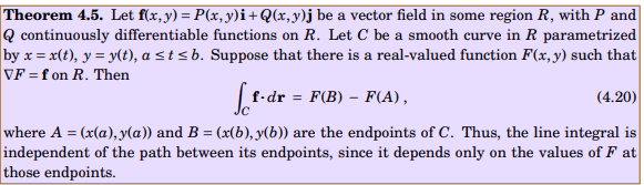

A real valued function F(x,y) such that $\nabla {F(x,y)}=f(x,y)$ is called potential for f. A conservative vector field is one which has a potential.
Now, in our problem, we have to show that $\vec{F} =\frac{yi +xj}{x^2+y^2}$ is a conservative vector field (It has a potential).
Thus, a potential $\mathcal{F(x,y)}$ for $F(x,y) = \frac{yi}{x^2+y^2} + \frac{xj}{x^2+y^2}$ exists, namely,
$$ \arctan{(\frac{x}{y})} + \arctan{(\frac{y}{x})}.$$
You can verify in your example that the value of line integral F along any curve C going from (1,0) to (2,0) or from (2,0) to (2,1) or from (2,1) to (1,1) and finally from (1,1) to (1,0) will always be zero. Since by above given theorem
$$\displaystyle\int_C\vec{F}\cdot d\vec{r} = \mathcal{F} (2,0) - \mathcal{F} (1,0) = \arctan{(\frac20)} + \arctan{(\frac02)} - \arctan{(\frac10)}-\arctan{(\frac01)} = \frac{\pi}{2} -\frac{\pi}{2} =0$$
