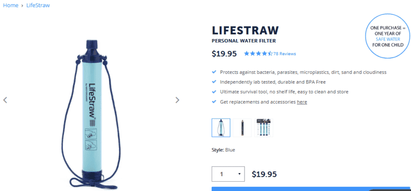

https://lifestraw.com/products/lifestraw
Likes sysprog
