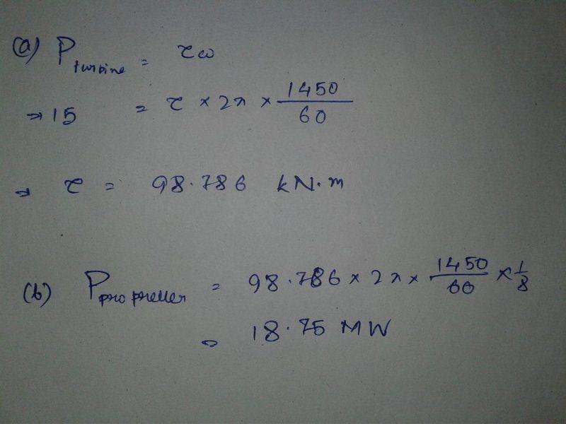

I have tried the above equations and also correctly calculated the 1st ans(2nd attachment) but I can't calculate the 2nd and 3rd ans... I hv approached the second one but ans is not matching.. pls help... also please explain it.. as i am very weak in it...

Hello Suman, :welcome:
why not use the same expression for b) as you use for a) ? You have ##\tau## and you have ## \omega## !

Yes.. but.. what is the value uf torque here ?

Yes I know. But how can I get the torque? If it is the resisting torque of water, then where goes the torque given by the turbine shaft ? Or will it be the difference between the above mentioned torques ?
For want of better you could start with that assumption ...

Ok I get the 2nd prt... and also the 3rd prt... thnks a lot.. but what is the significance of the 3rd part?
It's a giveaway: subtract 14.235 from 15. Too easy ! But it shows the gearbox needs cooling :smile:
