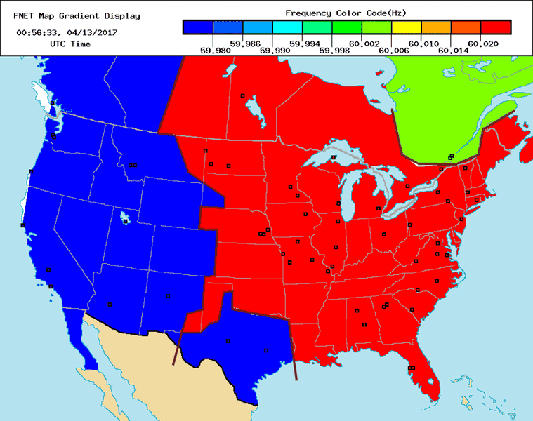

Have you seen this page? The power grid is a huge interconnected dynamic system with power flowing every which way.
Watch it in motion.

tim9000 said:
Which page are you talking about? This thread?
oops this graphic of US grid.. it's like watching a mobile swing in the breeze
http://fnetpublic.utk.edu/gradientmap.html
Ah that's cool, yeah I've been meaning to look into the 'droop characteristic' of how busses balance themselves by changing the frequency slightly or something, all I remember hearing is that the characteristic means that nothing needs to be controlled, it does it inherently. *I am aware that statement is probably conflating different aspects, and is wrong lol*
