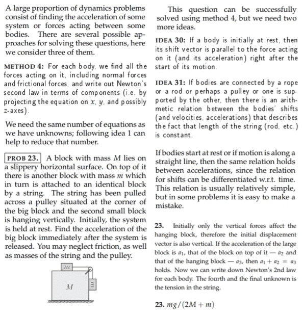

I was researching a problem that had once been posted here by someone else, and that had subsequently been posted (couched in somewhat different terms) here by me, and in doing the research, I ran across the following, which I think is the well-stated 'original version' of the problem.
Scanned page of a mechanics text: Problem 23 with a diagram of a block of mass M on a frictionless surface, a smaller block of mass m on top, a string over a pulley to a hanging block, plus solution text giving a = mg/(2M + m).
The problem, in both versions posted here on PF, the first of which I responded to, and the second of which I was the OP for, and regarding which in the ensuing discussion I participated, elicited controversy between me and other participants in the threads in which it was discussed.
Specifically, in the first of the two threads, I held that, and in the second of them, I strongly questioned whether, there would be leftward movement of the hanging ##m## block that was equal to and simultaneous with the lateral movement of the big block.
Given the problem as presented in the image above, if someone thinks that my supposition that the hanging ##m## block would not at any time after release descend vertically wrt its original position, but would remain at all times vertical wrt to the pulley, is incorrect, then that someone will please explain why.

@Dale, I think that the reply of @jedishrfu agrees with my supposition that the descent of the hanging ##m## block is not vertical wrt the ground below it, but is vertical wrt the pulley above it. Do you agree with that supposition? If not, please say why not.
The hanging block m will not begin to follow M until there is a horizontal component in the tension of the supporting string below the pulley. That requires a gap must form between M and the hanging block. For that reason the string cannot remain vertical.
Doesn't the descent of the hanging ##m## block drive the leftward movement of the ##M## block and the pulley? Isn't it true that the tension on the string is what transmits all of the leftward force? Isn't the leftward force of that tension applied as much to the descending ##m## block as to the pulley from which it hangs? If your answer to any of those questions is no, please say why not.
The initial behaviour is clear from analysing the forces. At ##t=0##, the string exerts a horizontal component of force on the ##M## block (via. the contact force at the pulley), but the string exerts only a vertical component of force on the ##m## block.
The horizontal displacement of the ##M## block is therefore ##O(t^2)## whilst the horizontal displacement of the hanging ##m## block is ##O(t^3)##. They will indeed separate by a small horizontal gap at small time values.

Why would it be that "the string exerts only a vertical component of force on the ##m## block", by which presumably you mean vertical wrt the ground, and not vertical wrt the pulley, when the pulley is impelled leftward along with the ##M## block to which it is attached? How can the hanging ##m## block move exactly as downward as it would if it were not hanging ##-## not connected to the string? What rightward force would for it 'zero out' the tension that is driving the leftward movement of the pulley and ##M## block?
At ##t=0##, hanging string is vertical.
And at ##t>0##, is it not still vertical wrt the pulley, but no longer vertical wrt the (starting downward point on the) ground? If not, then how does the pulley acquire any impetus to move lefward?
String pushes the pulley, which is connected to ##M##. Horizontal component of this force accounts for horizontal acceleration of ##M##.

The problem as presented asks about the "acceleration of the big block immediately after the system is released". At the time point of release the string is still vertical, so that can be assumed as given. Thats why the solution starts with "Initially..."
None of that says anything about velocity of the block later, at some time after release.

A vertical rope cannot apply any horizontal force to the hanging block. So any horizontal acceleration of the hanging block implies the rope is not vertical anymore.

No. Because to move left, the hanging mass needs a leftwards force. That might be because it is attached to the large mass ##M##. That's the simplest problem to solve.
If it's not attached to the large mass, it can only be pulled left by the string. And, by assumption, the string is incapable of exerting a lateral force. Therefore, the string itself must be at an angle in order to pull the hanging block leftwards.
This is elementary: there can be no leftwards force on the hanging mass until the string is at an angle. The mass will swing out relative to the block as the large block moves leftwards. Eventually reaching or oscillating about some equilibrium angle.
It cannot be pulled leftwards by a vertical string.

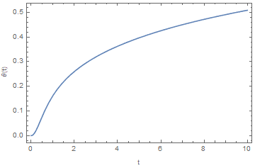

So I realized that my Lagrangian above assumed that the string was always vertical. Since that is being questioned then I should not make that assumption. So I have one extra degree of freedom and I have to rewrite my Lagrangian. Including that degree of freedom definitely complicates things.
So I have ##x## which is the horizontal position of the pulley, ##r## which is the amount of string between the pulley and the hanging mass, and ##\theta## which is the angle of the string with the vertical.
The position of the big mass is simply ##x## so its velocity is ##\dot x## and the corresponding KE is ##\frac{1}{2} M \dot x^2 ##
The position of the little mass on top is ##x+r## so its velocity is ##\dot x + \dot r## and the corresponding KE is ##\frac{1}{2} m (\dot r^2 + 2 \dot r \dot x + \dot x^2)##
The position of the hanging mass is the most complicated. It is ##(r \sin(\theta) + x, - r \cos(\theta))## so its velocity is ## (\dot r \sin (\theta )+r \dot \theta \cos (\theta )+\dot x,-\dot r \cos (\theta
)+r \dot \theta \sin (\theta) )## and the corresponding KE is ##\frac{1}{2}m( 2 \dot r \sin (\theta ) \dot x+\dot r^2+r^2 \dot \theta^2+2 r \dot \theta \cos (\theta) \dot x+\dot x^2 )##.
The potential energy is ##-m g r \cos(\theta)##.
To simplify this a bit, I will assume that ##\theta## is small, so ##\cos(\theta)=1## and ##\sin(\theta)=\theta##. So the new Lagrangian with the extra degree of freedom is $$L=m r \left(g+\dot \theta \dot x\right)+\frac{1}{2} (2 m+M) \dot x^2+m (\theta+1) \dot r
\dot x+m \dot r^2+\frac{1}{2} m r^2 \dot \theta^2 $$ I would not mind at all if someone could check this. Even with the small angle approximation it is a pretty hairy Lagrangian.
There is a conserved energy and a conserved momentum conjugate to ##x##, which I won't write down. The Euler Lagrange equations are: $$ -(2 m+M) \ddot x-m (\theta +1) \ddot r-2 m \dot r \dot \theta -m r \ddot \theta =0$$ $$ m \left(g-2 \ddot r+r \dot \theta ^2-\theta \ddot x-\ddot x\right)=0 $$ $$ -m r \left(2 \dot r \dot \theta +r(t) \ddot \theta +\ddot x\right)=0 $$
This doesn't appear to have an analytical solution, so I will do a numerical solution with ##g=10##, ##m=1##, and ##M=5## with ##r(0)=1## and all other initial conditions set to 0. This gives the following plot for ##\theta##
Line graph of a function against t from 0 to 10: it starts at 0 near t = 0, rises steeply to about 0.3 by t = 3, then climbs more slowly to about 0.5 at t = 10.
So we see here that ##\theta## starts at 0 (since that was my initial condition) and then is always positive. That means that the string is not vertical except at the beginning, and then only because that was my initial condition.

No, I got more than 0.5 radians at long times and -0.09 g was closer to my initial acceleration than my long-term acceleration. It didn't really seem to have an equilibrium.
I suspect that the small angle approximation is not valid. Did you use that?
That seems like a lot. Nearly ##30## degrees?
