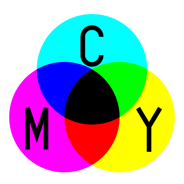

Hello,
When reading a bit about substractive color mixing, a question came up.
I understood that when mixing Cyan, Magenta and Yellow paint, you would get black because all these 3 colors that get reflected by each corresponding paint are absorbed by the other paint in the mix, leaving no color behind to get out of the mix.
Furthermore, it is stated that when mixing only Cyan and Magenta paint, you would get Blue coming out of the paint mix. This is explained by the fact that Cyan consists of a combination of Green and Blue wavelengths while Magenta paint consists of a combination of Blue and Red wavelengths.
Since Cyan paint absorbs the Red part of the Magenta, and Magenta absorbs the Green part of the Cyan, Blue is left behind and comes out of the mix.
Here’s where my question comes up. What if Cyan is not a mix of Blue and Green wavelengts but a pure Cyan wavelength itself? And the same goes for Magenta, having its own wavelength. Doesn’t that mean that when mixing those two colors, you would get black since Cyan absorbs the Magenta wavelength and Magenta absorbs the Cyan wavelength, leaving no color behind to leave the mix?
In the subtractive color system, or CMYK (subtractive), which can be overlaid to produce all colors in paint and color printing, cyan is one of the primary colors, along with magenta, yellow, and black. In the additive color system, or RGB (additive) color model, used to create all the colors on a computer or television display, cyan is made by mixing equal amounts of green and blue light. Cyan is the complement of red; it can be made by the removal of red from white light. Mixing red light and cyan light at the right intensity will make white light.
So your question, "What if Cyan is not a mix of Blue and Green wavelengts but a pure Cyan wavelength itself?", is meaningless because, by definition, cyan is the complement of red.
Cyan is a colour. The way it can be produced is irrelevant. It is 'defined' in one way when it suits the system.
