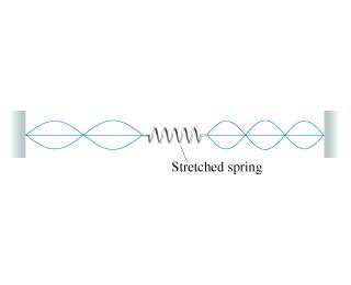

The discussion revolves around calculating the linear density of two strings driven at equal frequencies, with the left string having a known linear density of 2.4 g/m. Both strings experience the same tension, and the wavelengths are related to their lengths, with the left string's wavelength equal to L and the right string's wavelength equal to 2/3L. The equation μ = T/(λ/f)^2 is used to derive the linear density of the right string, leading to the expression μ = 9Ts^2/(4L^2f^2). The participant is seeking clarification on the algebraic steps to arrive at the correct answer, as they consistently obtain 2/3 instead of the expected value. The discussion highlights the importance of correctly applying wave equations and relationships between tension, wavelength, and frequency in solving the problem.

The two strings in the figure are of equal length and are being driven at equal frequencies. The linear density of the left string is 2.4 g/m
AND ATTEMPT AT SOLUTION
Assume that while the spring provides the same tension to both strings it also acts as a fixed
point for the end of each string so an integral number of half wavelengths fit in each string.
Visualize: Use a subscript L for the left string and R for the right string. We are given μL = 2.0 g/m. From the
assumption above we know (Ts left ) = (Ts right ) = Ts . We are also given frequency left = frequ. right = frequency Notice from the
diagram that λleft=L and λright=2/3L
From v =λ f and s v = T /μ eliminate v and solve for μ : μ = T/(λ/f)^2
I am stuck here and keep getting the wrong answer. Can someone please explicitly solve this for me (include even algebraic steps because I keep just getting 2/3 for my answer)
The Attempt at a SolutionSince the linear density of the left string is 2.4 g/m and the tension on both strings is the same, we can use the equation μ = T/(λ/f)^2 to find the linear density of the right string. We know that the tension on both strings is the same (Ts left ) = (Ts right ) = Ts and the frequency of both strings is the same (frequency left = frequ. right = frequency). Furthermore, since an integral number of half wavelengths fit in each string, we know that λleft=L and λright=2/3L. Therefore, we can plug in all of this information into the equation and solve for μ: μ = T/(λ/f)^2 = T/(2/3L/frequency)^2 = Ts^2/(4L^2/9f^2) = 9Ts^2/(4L^2f^2) Therefore, the linear density of the right string is equal to 9Ts^2/(4L^2f^2).
