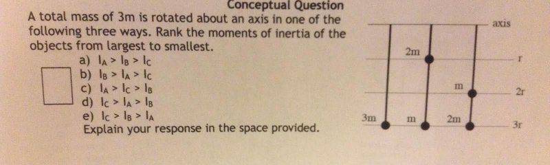

I= ∑ miri^2 ?
I'm not sure on how to start this problem. How exactly do I know which one is IA, IB, IC since it didnt specify? Can somebody please hint me in solving this problem?
There's no way to know for sure, but I would guess they are A, B, C from left to right.
By the way, this belongs in Introductory, not in Advanced.
Oh I'm sorry about that, how do I move the thread over? Kinda new to this.

Ah okay. Do you think you can help me with the question though? I'm not really sure where to begin.
Let's start with the leftmost picture (A, presumably). There is only one mass. What is the mass, and how far is it from the axis? What does the ∑miri2 formula give you?
