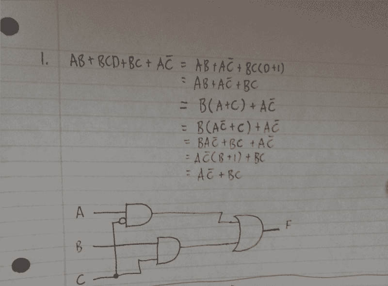

1. Reduce the following logical expression to four literals and draw a gate level circuit, which implements the result.
$$AB + BCD + BC + A \bar C$$
2. Simplify the following:
$$(A + \bar B C)(B + C)(B + \bar C)$$
I would just like to verify I understand.
Here is my working for part 1:
For part 2 here's what I came up with:
$$= (A + \bar B C)(B + C \bar C)$$
$$= (A + \bar B C)(B + 0)$$
$$= (A + \bar B C)B$$
$$= AB + \bar B B C$$
$$= AB + 0C$$
$$= AB + C$$
I think that's as simple as it can become.
Thank you.
A good way to check your work is to draw the Karnaugh Maps and see if the simplest grouping of terms matches your equation manipulations. Can you show us the corresponding K-Maps for this question? :-)
I have a few more pages before I get to K-Maps today. I actually just started this subject so I don't know much, but I'm working on it.
You are going to like K-Maps! :-)
BTW, I got a different answer for part 1) using a K-Map. I'd be interested in seeing what you get using that method when you get to it.
Note for Q2 that 0C = 0
