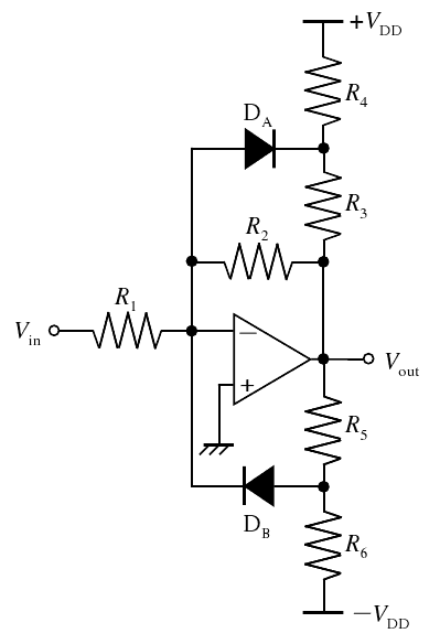

The original circuit of the was the one below. I had to find the states of the 2 diodes when Vout goes from -Vdd to + Vdd.
So I wanted to know what is the voltage between R4 and R3, to check the state of the diode DA ( such V must be negative since Diode is connected to the virtual ground of the op-amp). According to my solution:
From KCL at the node between R4 and R3 we get: V = Vdd (R4-R3)/(R4+R3)
Since a condition for Diode 1 to be on is that its voltage must be greater than Forward voltage ( 0 - V > Vd , and since we know from the problem that Vdd >>> Vd, I reach the following inequation: R3 > R4, which I guess may be a condition for DA to be on.
What do you think?
Your new diagram is quite different from the previous one. Conserningh the latter we can write the following:Suppose that DA is inversely biased. Then, from the KCL for the node between R3 and R4, we ought to get:
<br /> \frac{V_{\mathrm{DD}} - V}{R_{4}} + \frac{V_{\mathrm{out}} - V}{R_{3}} = 0<br />
where V is the potential of that node. Solving for it, one gets:
<br /> V = \frac{R_{3} \, V_{\mathrm{DD}} + R_{4} \, V_{\mathrm{out}}}{R_{3} + R_{4}}<br />
A similar assumption for DB being inversely polarized leads to the following KCL equation for the node between R5 and R6:
<br /> \frac{V_{\mathrm{out}} - V&#039;}{R_{5}} + \frac{-V_{\mathrm{DD}} - V&#039;}{R_{6}} = 0<br />
Solve this for for V'!
In this way, you have the potentials on which the n-terminal of DA and the p-terminal of DB are. You need to find the potential on which the p-terminal of DA and the n-terminal of DB are. From the circuit, you see that both of these terminals are connected at the same node as the "-" input terminal of the OP-AMP (as well as R1 and R2).
What properties of the OP-AMP is important in deducing the potential of this point?
After you had found it, what conditions must be met in order that the assumptions made in the beginning that both diodes are inversely polarized are both correct?

Thanks for your reply.
Hmm... I don't think so, since the problem asks you for the states of the diodes when Vout is changed from -Vdd to +Vdd... (In the first diagram I wrote the case of Vout=-Vdd)
<br /> V = \frac{R_{6} \, V_{\mathrm{out}} - R_{5} \, V_{\mathrm{dd}}}{R_{5} + R_{6}}<br />
By the way, could you please explain me how did you get the KCL? Why are the two currents entering at the node?
maybe?
I guess that both diode terminals are connected to a virtual ground, hence 0V.
V > 0 and V' < 0 ?
My two currents are entering the node, so that their sum must be zero.

I change my question, Why when the diode is in reversely biased, the 2 currents are entering to the node ?
Because there is no current flowing through the diode when it is inversely polarized.
Thanks. I understood that since it is reversely biased, the current entering through the diode should be 0. My question is about the direction of the other 2 currents. Why are both of them entering the node ? I thought one was entering, and one was leaving...
You can always assume a direction of the current and if you get a negative result it means it flows oppositely of what you assumed.
