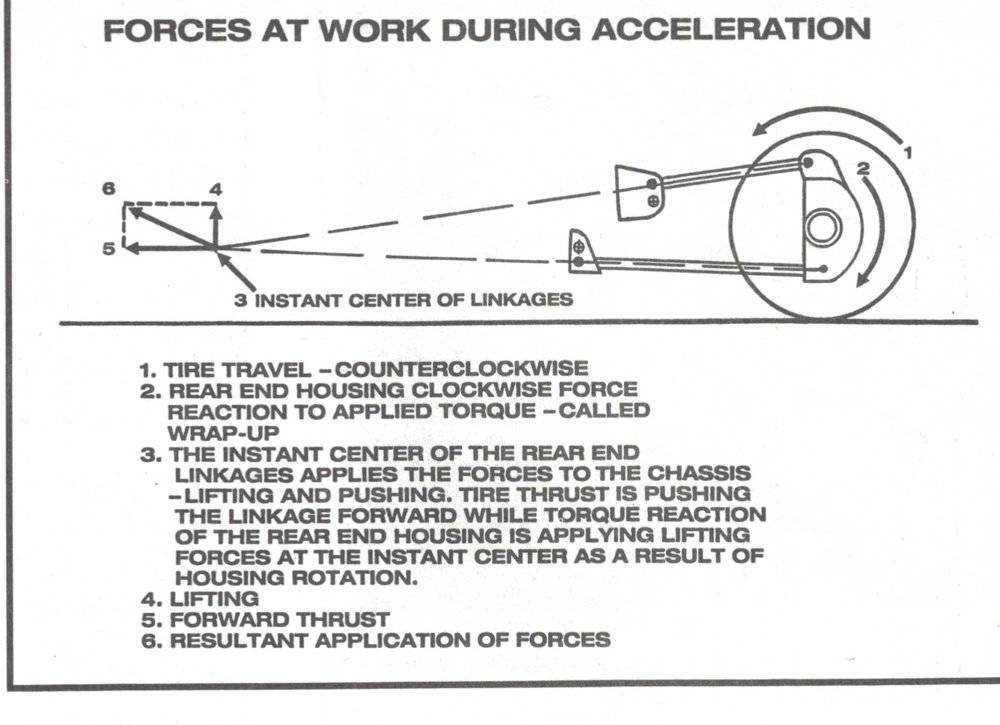

Couple of quick observations. This Center pull suspension with J bar links combines the best of 4 link and 3 link suspensions. The 4 link is the best set up for dirt as you need maximum traction tuning. This center pull set up eliminates the lower links of the 3 and 4 link suspension. Less weight hanging below the axel and less garbage to get snagged up on a bad track. Everything is above the rear axel tube out of harms way.
Look at the Instant center angle. I do not have the hard numbers but it sure looks like the intersection of the two J bars and the pull bar is way out in front of the axle. Like 10 foot in front of the car! We want the angles of the rear suspension linkage to form an Instant Center (IC) as far forward as possible. This longer lever cushions the acceleration when the tires hook up. This set up does not have a shock damper on the top link. Too short an IC distance means we have a lot of angle change on both sides and the car will be real darty when you nail it. Longer is better and gives the driver more control because you don't have a lot of angle change as the shorter IC has. The top link angle can be zero to 5 degrees down hill for traction.See attached forces on rear axle -
It is easier to pull a chain than push it. Race cars love forces that directly pull versus forcers that push and this set up is strictly a PULL. All links are pulling on the chassis. We have more initial static angle on the driver side of 6 ° and the right side angle of 12 ° . This means the car in chassis roll will grow more angle in chassis ROLL as the right side angle reduces as the right side springs compress. This is a feature that 3 link has but to a much lesser degree due to the limitations of the lower links. About the only thing you could to bias the rear wheel loading was to off set the top link mount. With the J bar design you can dial in rear wheel load directly to each wheel.
This is HUGE!
Question for you to ponder- What happens when the rear end is in Roll? What happens to wheel base on left and right side?
  • #1,500
This is HUGE!
Just by watching the cars running it at the Derby that won and have it figured out already it was essentially moving like a dirt car, the left rear tire was traveling into the fender well, the rear of the car was rising and the left ear tire was just being pounded into the pavement. We all know modifieds with 8" tires are an animal at the end of the race but mot anymore with this setup. same thing with the super Late models. I will add they are running the rear calipers on the bottom of the axle tube also. Yet again this is things I've seen on dirt but am not familiar with dirt as we've always ran pavement.
