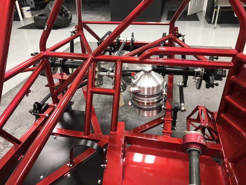

  • #1,501
Shorttracker93 said:
Just by watching the cars running it at the Derby that won and have it figured out already it was essentially moving like a dirt car, the left rear tire was traveling into the fender well, the rear of the car was rising and the left ear tire was just being pounded into the pavement. We all know modifieds with 8" tires are an animal at the end of the race but mot anymore with this setup. same thing with the super Late models. I will add they are running the rear calipers on the bottom of the axle tube also. Yet again this is things I've seen on dirt but am not familiar with dirt as we've always ran pavement.
Several of the faster cars this year were "conventional" three link cars (DQ'd winner, and pole sitter for sure). Looking at them from a distance it appears they run a little more angle on the lower trailing arms, and the upper closer to the axle tube center than the classic recommendation. With a more "drag car" like IC, I'm perplexed as to how they soak up the off-throttle reaction. In the past when I've tried that it was automatic wheel hop. Perhaps the high spring rates and advances in shocks.
The other part of the puzzle is the new take on front...lot's of LF anti-jacking while the RF stays very similar to old-school.
If I'm not mistaken, this is representative of a fast car at the Derby this year.
  • #1,502
Ranger Mike said:
Couple of quick observations. This Center pull suspension with J bar links combines the best of 4 link and 3 link suspensions. The 4 link is the best set up for dirt as you need maximum traction tuning. This center pull set up eliminates the lower links of the 3 and 4 link suspension. Less weight hanging below the axel and less garbage to get snagged up on a bad track. Everything is above the rear axel tube out of harms way.
Look at the Instant center angle. I do not have the hard numbers but it sure looks like the intersection of the two J bars and the pull bar is way out in front of the axle. Like 10 foot in front of the car! We want the angles of the rear suspension linkage to form an Instant Center (IC) as far forward as possible. This longer lever cushions the acceleration when the tires hook up. This set up does not have a shock damper on the top link. Too short an IC distance means we have a lot of angle change on both sides and the car will be real darty when you nail it. Longer is better and gives the driver more control because you don't have a lot of angle change as the shorter IC has. The top link angle can be zero to 5 degrees down hill for traction.See attached forces on rear axle -
It is easier to pull a chain than push it. Race cars love forces that directly pull versus forcers that push and this set up is strictly a PULL. All links are pulling on the chassis. We have more initial static angle on the driver side of 6 ° and the right side angle of 12 ° . This means the car in chassis roll will grow more angle in chassis ROLL as the right side angle reduces as the right side springs compress. This is a feature that 3 link has but to a much lesser degree due to the limitations of the lower links. About the only thing you could to bias the rear wheel loading was to off set the top link mount. With the J bar design you can dial in rear wheel load directly to each wheel.
This is HUGE!
Question for you to ponder- What happens when the rear end is in Roll? What happens to wheel base on left and right side?
RM, I've been watching this center-pull setup with keen interest since it first started winning (lots of aero on outlaw bodied cars). Firstly trying to figure out how to model it to understand if it's actually better in force management and location or just a shiny object (winners win, builders sell cars). On the modeling since it appears to give another element of freedom in the linkage. Also, one spring/shock assembly is mounted in front of the axle which helps on the off-throttle torques. So far, the best way can understand the IC effect is to model it like IRS, from the center of the axle tube and not from the tire patch. A second reason I lean toward that understanding is that the spring rates used in the competitive cars are very stiff. Another reason is that the actually-running setup I tried to model would up having the linkage intersection point looking like that of a Viper or modern Corvette, really high. Racers are using bumpstops in both rears with very high rates. Also, very low rear roll centers. Panhards under the driveshaft, 6"-7" RC height. So with the steep upward angles you get a lot of desired roll steer, but the bad potential for wheel hop checked by more freedom and dampening than traditional. I'm guessing, but my real question is how to appropriately model the forces.
As I noted to STT93, though, traditional 3 links are still running fast...but with a lot of angle in the links. No idea on the spring rates on those though. Those cars are on bumps on the front, so I'm educated-guessing 1500-2000+ lb/in front, 400-900 on the rear. Can super high tech shocks and high spring rates (less travel) make the difference on wheel hop issues with radical IC's??

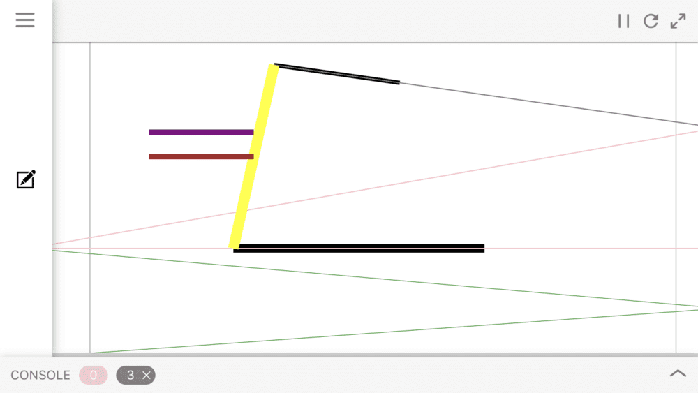

  • #1,508
Spindle height is distance from upper ball joint to the center line of the spindle pin. The only bearing the tire diameter has is where it places the ball joint centers relative to the pavement. This is why you just about have to have a good software program to follow things like tire diameter and its effect on the spindel height , effects on suspension link angles that make instant centers that make Roll Centers.
  • #1,509
Makes sense Ranger Mike. We're using spacers on the top and bottom of the spindle to move the upper and lower ball joints to get the desired Y coordinates for roll center.
But got to thinking about what would be the optimal spindle height. The attached image shows the brown line is center of upper and lower balljoints and the purple is where you end up with spacers to get all points and match spindle snout to tire.
The brown and purple lines are going to move along the travel arc at differently, so to your point, you need to understand the dynamic affects of this stuff.
Is Performance Trends Suspension Analyzer still the recommended software these days?
BTW, thanks for sharing all your knowledge.
  • #1,510
Thanks fro the input Cave
i like Perf Trends but there are many other softwares out there. I like sys Analyzer as it has dynamic graphics ti display where things are moving during roll and dive. price is good too...

Got one for you Ranger Mike, how to find the roll center on an asymmetrical triangulated four link. All of the stuff I've seen online is for symmetrical, never for asymmetrical. This is on a GM metric chassis. From a top view, the trailing arms are all symmetrical. But from a side view all 4 of the trailing arms have different angles. The upper trailing arms are fairly close in angle, within a couple degrees. The biggest difference is in the lowers, the left lower has around 15 degrees, and the right lower has around 3 degrees. The upper and lower trailing arms never form instant centers because their paths never cross, so I'm thinking it has something to do with taking an average instant center height between the left and right trailing arms but I'm not sure. Let me know what you think, thanks.
One of the articles I was referencing: https://www.onedirt.com/tech/chassis-suspension/finding-your-center-finding-your-front-and-rear-roll-center/
  • #1,528
when you buy the software and input the susepsion settings it replicates your actual set up. So if you run a longer right side upper and lower A-arm it will show up and calculate the RC and other info. Same with elevation readings. All built in and well worth the $$$

I'd like to expand a little on dontlift19's question but more so when designing a front end that might have unequal lowers. In reading the earlier posts you go over the design of a front end and the placement of the roll center a few inches to the right of centerline. What if you wanted to design the optimum front end for an offset chassis car? Would you even up the lowers arm and move the mounting points or center the mounting points within the chassis and use uneven lower arms. (Note: I haven't used my software enough to get a great grasp on what the impact will be so looking for a little head start)
Thanks!
  • #1,530
Lets review. The reason we have non equal a-arms is for maximum placement of weight on left side. We offset the front roll center to the right is to load the right front tire with down force to get maximum traction.
When we off set the engine to the left (vs stock location) we make the lever distance between the engine camshaft center line (COG) to the front RC longer. More leverage. If we hook up too much on right front we may lift the left front tire (sprint car style) so we have to be careful when we go max route on anyone setting. In outlaw anything goes super late models you do it all. The longer a-arm thing will take more time to get RC right but when you go all out, it takes time and money. More restricted classes dictate the rules and what you have to do.
There are so many variables that your question is pretty hard to answer. Ifin you are designing the ultimate front end I would go with the Indy car design of both lower A-arm mounts being equal height above track ( parallel ) same as upper mount points. Go max left side weight
Max engine offset, driver offset even rear end housing change to shorter axel on left side. Low left and fast. Then tweat ROLL center offset and location and minimum of RC migration ( within an inch of static at max roll).
