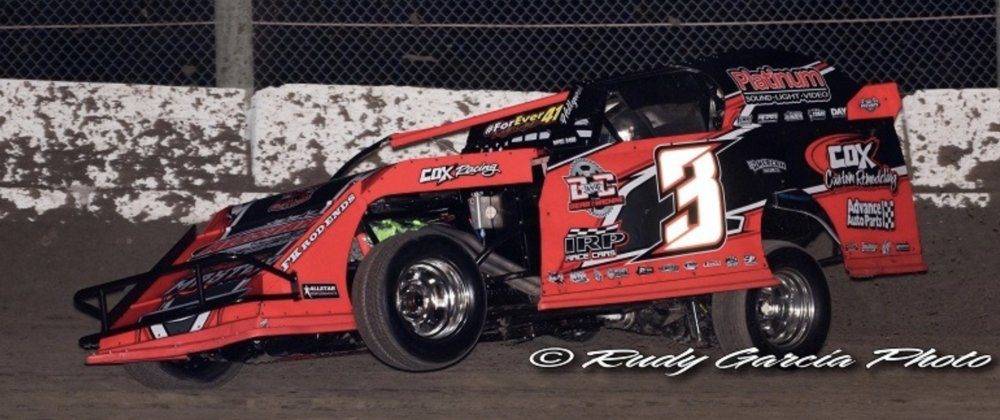

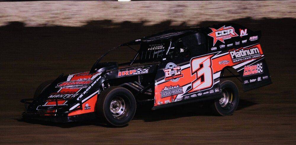

Man what a difference a year makes! Hey Guys, just wanted to thank you for the input you gave me on our dirt mod that was lifting the left front Really bad! We went from a mid pack race car to now winning our 7th race of the year. We won 2 track championships and a Sunoco summer series event this year alone. Couldn’t have done it without you guys and this awesome forum! And yes this is the same car!
Black and orange dirt modified race car number 3 with Platinum sound and video sponsor decal, racing on a dirt track at night.
Ranger Mike, logicindustries you guys are the best! Couldn’t have done it without you both. So thankful for this forum, the information is here! just got to read it, understand it and apply it! Felt like a real dummy asking for help but now I’m so glad I did!
