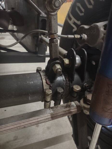

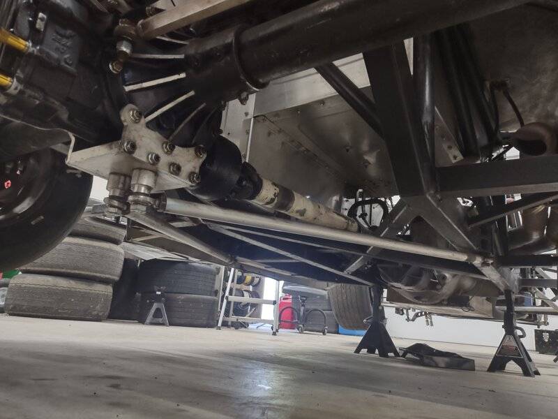

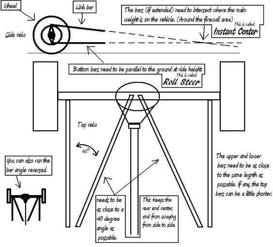

Evening Ranger Mike. I'm using a triangulated 4 link on the rear of my vintage modified. Can you explain to me how changing the bar angles will affect the handling?

This set up has advantage of more lateral support for the rear end. You have vectors acting to each chassis mounting point as well as the Panhard bar. I suspect the pivoting in rear roll over steer will be quicker as the forces are acting at an angle to the lateral forces and not at 90 degrees as the traditional 4 link does.
The upper links can be adjusted same as the traditional upper links are.
see post 132 on page 4 for details on 4 link

Thank you sir! I will read up on it. I'm happy with the setup so far but I'm working to optimize it
the upper link settings are a given as much has been written on this. You have jack up the car, wheels off, set the rear end at track level ( read up on this in my earlier posts) measure both side wheel bases at track level, then at max roll so right side is in compression and left side in droop, then you can see if the rear end remains neutral, or goes into roll over steer or under steer. Until you do this you won't know what is going on when cornering

That makes sense. Eliminating the panhard bar saved me about 23 lbs of weight in the correct spot

here is the situation. you eliminate the panhard bar and this will lower your rear RC. Forget about tuning with the rear RC. REAR ROLL CENTER. Everything is centered about this point. Effectively you still have a 4 link suspension but now without a solid anchor to take care of the rear weight momentum going to the outside (panhard bar). Lateral momentum ( sometime called weight transfer..arrrrrrr) thru the RC motion gets you to mid corner without spinning out or heading to the guard rail. Now the chassis is set and ready to come back to neutral. All Roll over steer does lets you run in the turn deeper before getting off the go pedal. Then you tune with the upper links for forward bite. RC tuning is critical on any track. Must have. The virtue of the panhard bar is you can raise it to loosen the car or lower it to tighten the car very quick and easy, loosen tow bolts , tape measure it and retighten, Me, I like vectors working at 90 degrees so i can deal with it easier. You go using angular vectors and things get complicated and at a race track in the heat of the moment..i do not need this. I leave finesse to the Formula One boys that got lots of extra help, worthless as they may be. Put the panhard bar back on. 23 # is 3 gallon of fuel. You should be racing with fuel cell anyway for safety.
Hi Vintage 13! How can you have two points of lateral control, on the center of the rear, one on a arc and one in a straighjt line perpendicular to the bottom of the frame, and not have a bind when it goes into roll, or straight up and down movment?

I don't have a good enough understanding of why it works but it does. The car I copied has won every feature but 2 this year and won the championship last year. The car rolls the center very well and also doesn't have a panhard bar. With this setup I feel the panhard would cause a bind. To me it essentially the same as the A or G body GM suspension that is used in street stock racing. I would love to see it modeled in a software program to see how it actually works
V-13 sorry I thought you had a panhard bar. what is the octagon bar on the right side in your pic . With a closer look I see it is not connected to the frame. Your bottom rods mounted so close at the bottom of the rear is almost triangulated. That would give you a very low roll center, for the rear, that would travel close to a straight line perpendiclar to the mount points on the bottom of the frame. It will move slightly to the right if you have left rear leed and the opposite with right leed. The roll center height should be at the heims on the rear.

The bar you see is a toe bar to keep the axle tube straight

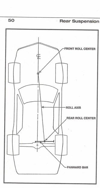

What is the correct length a panhard should be . How far in front of the right rear axel tube center line should it be ? Asphalt late model on 8 inch tires perimeter chassis.

SDavem- Panhard bar roll center is the center of the bar and is the easiest to tune due to both side mounting point adjustments. You have a small 8 inch tire so traction is going to be everything. The rear roll center is very important here. You need a lower roll center to improve bite. Roll center should be between the bottom of the ring gear (assume Ford 9") and just below the rear axle tube. 10 to 11 1/2 inch is ball park. How much wedge or cross weight % do you have? From your description you have a short panhard bar that will place the rear roll center at a diagonal to the front end.
Note- If your front roll center is located at the center point of front tread width. If it is offset 3 inch to the right side, I try to make the rear roll center offset three inch to the right. If you have the fronmt RC other than described, you must add more spring rate to one side just to compensate the car handling. I personally do not like this as the roll center will not be in line and this adds complexity to the spring tuning. I like a very long panhard bar mounted at the rear of the housing. Longer levers throw much less chassis bind in the setup. Can you relocate? What is the mounting point location of top link relative to the track width? What % left side weight do you have? Photo from Steve Smith book Paved Track Stock Car Technology
