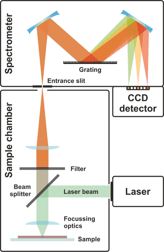

Least you could do is google raman spectroscopy and try to find out what prof could be thinking of. Perhaps he is my age and designates anything resolving a spectrum as 'prism' -- even if nowadays it all done with gratings.
Other places where spectral dispersion comes in is in the laser tuning or the filter.
(wikipedia picture after T Schmid, P Dariz, Heritage. 2 (2): 1662–1683)
