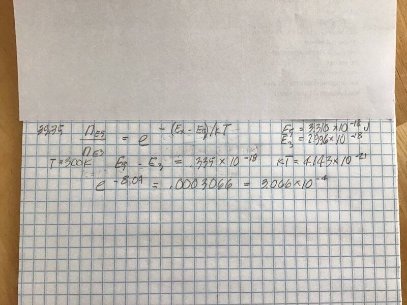

A large number of neon atoms are in thermal equilibrium. What is the ratio of the number of atoms in a 5s state to the number in a 3p state at 300 K? The energies of these states, relative to the ground state are E 5s = 20.66 eV and E 3p = 18.7 eV.
n5s/n3p = e ^-(E5 - E3)/kT

Found in less than 30 seconds using ck12.org/flexi (free access) :)
Thanks. I worked it in Joules and found my arithmetic mistake.

What is your question? Are you asking us to check your work? Is that because it doesn’t give the answer you expect?
You need to be clear about what your are asking and it helps us to know why you are asking it.
Here are mistakes I spotted in your work. (There might be others.)
The expression ##e^{\frac {-(E_x – E_0)}{kT}}## makes no sense. Presumably you mean ##e^{\frac {-(E_5 – E_3)}{kT}}##.
##3.310 \times 10^{-18} - 2.996 \times 10^{-18}## is not ##0.335\times 10^{-18}##.
Your incorrect value of ##0.335\times 10^{-18}## divided by ##4.143 \times 10^{-21}## does not give ##8.06##.
The message is to check arithmetic carefully. Also, units are missing in various key places.
It's worth noting that you could simplify the arithmetic by looking-up and using the value of the Boltzmann constant (##k##) in units of eV/K.
Edit. Didn't see your Post #3 until after I'd posted.
Correct. I was not used to using the Boltzmann constant in EV.
