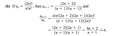

Investigate the convergence of the following series.
(2n)!/(n!n!)
Number one, I don't see how they get that
if an = (2n)!, then an+1 = ((2n+2))!, it should be (2n+1)!
Number two, I don't see how they go to the second step, why is the second step not:
(n!n!(2n+2)!)/((n+1)!(n+1)!(2n)!)? why do they have that extra (2n)! in the numerator?
Number three, I don't see why n!n! cancels in the numerator in step 3.

Number one:
an+1 = ((2n+2))! results from basic substitution.
If [itex]\displaystyle a_{n}= (2n)!\,,\ \text{ then }a_{n+1}=(2(n+1))!\,,\text{ so that }a_{n+1}=(2n+2)![/itex]
Of course, this is not the same an as in the image you posted.
[itex]\displaystyle \frac{n!n!(2n+2)!}{(n+1)!(n+1)!(2n)!}=\frac{n!n!(2n+2)(2n+1)(2n)!}{(n+1)!(n+1)!(2n)!}[/itex]
This is because
[itex](2n+2)!=(2n+2)((2n+2)-1)((2n+2)-2)((2n+2)-3)((2n+2)-4)\dots(3)(2)(1)[/itex]
[itex]=(2n+2)(2n+1)(2n)(2n-1)(2n-2)\dots(3)(2)(1)[/itex]
[itex]=(2n+2)(2n+1)(2n)![/itex]​
[itex](n+1)!=(n+1)(n!)[/itex]
