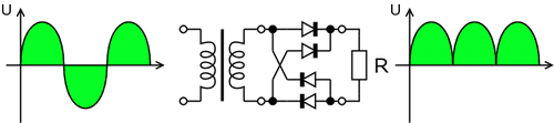

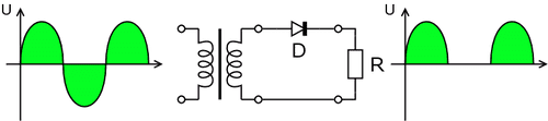

Does rectification of AC into DC with the use of diodes always create a fluctuating DC wave? Are there methods of rectification which create a steady DC current or do you always have to smooth the current out afterwards?
I'm having a hard time grasping the concept of half-wave and full-wave rectification. Are there any advantages to half-wave rectification or is it only used because it's a simpler method of rectification?

Half-wave rectifier circuit: left, a sine wave input with its negative half-cycle shaded green; centre, a transformer feeding a diode D in series with a resistor R; right, the rectified output showing only the positive half-cycles as green humps.
Diagram of a full-wave bridge rectifier: a sine wave input with positive and negative halves on the left, a transformer and four diodes with load resistor R in the middle, and the rectified output as three positive hump waveforms on the right.

I can see why an AC current flowing through a diode would create a half wave rectification. I haven't tried to understand full wave rectification circuits yet. Would a fluctuating DC current perform as well as a steady DC current in a basic circuit like a flash light? I'd imagine a half wave DC current would make the light flicker since the voltage constantly goes on and off but would a full-wave DC current power the light bulb the exact same way a steady non fluctuating current would?
If the DC current is fluctuation, but never going in reverse, then the diode stays forward biased, and the only effect is that you get about a 0.7V forward drop across it.
You can drive a light with an AC or fluctuating DC current, and as long as the fluctuations are at a frequency above the "flicker fusion frequency" of the human eye (around 70-80Hz, I think for most people), then no flicker will be perceived.
Berkeman overlooked that a filament in a flashlight lightbulb is a slowly responding load. It won't flicker using halfwave rectified voltage at 50 or 60Hz, because the supply pulses more rapidly than the filament has time to heat up and cool down. It is also a simple way to make a dimming switch. Using a fullwave supply for bright light and halfwave supply for dimmer light.

There is a circuit configuration called Fullwave bridge filter circuit. A capacitor is used between the output and load. This reduces the ripple and smooths out the current.
You should look into this.
Does one have a link.
I found this - http://www.allaboutcircuits.com/vol_3/chpt_3/4.html
I think there will always be some ripple. In addition to pooface's recommendation, there are system using multiple AC phases in which each is separately rectivity, and one can always increase the AC frequency to high frequencies. One does not have to be constrained to 50/60 Hz if the generator is isolated/alone.
