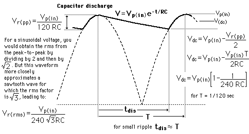

I have some confusions regarding rectifier circuits.
I was wondering does any change happen to the rectified dc voltage if i change the load resistance. I was thinking even if the current change with the change in resistance, there should not be any change in the voltage. But, it seems it is not so..
And how do I calculate the capacitance of the smoothing capacitor I need.
And also, does the capacitor charge up completely and discharge completely in each cycle of AC irrelevant of the capacitance and the frequency of the AC signal..??
Thanks.

This page at Hyperphysics should help answer your questions:
http://www.google.com/imgres?imgurl...ltage+calculation&hl=en&gbv=2&tbm=isch&itbs=1
The capacitor discharge plot given by berkeman is very important for an additional reason. The rectifier "ON" time per cycle is tON = T - tdis. The peak repetitive rectifier charging current is inversely proportional to this ON time, and can easily exceed the rectifier specs if the filter capacitor is too large.
