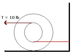

In the discussion on red rope tension and wheel movement, participants analyze the relationship between tension and acceleration in a pulley system. The formula Tension = mg - ma is emphasized, where 'm' is the mass of the block and 'a' is the acceleration. It is concluded that if the red rope is attached at the bottom, the tension would be zero due to the direction of the forces acting on the wheel. When the wheel is stationary, the red rope would exert a force equal to the brown rope, which is 10 lbs. However, if the wheel is in motion, the tension in the red rope becomes zero, highlighting the complexities of force analysis in dynamic systems.
