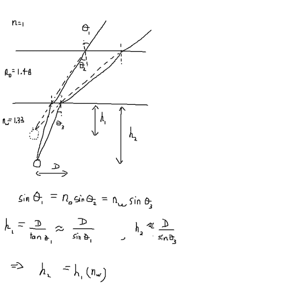

For the second part, I got an answer that is indpendent of the index of oil? That woud mean that the answer would be the same as putting it directly through water..
No clue about the third part.
