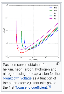

It's hard to understand what you are describing, but perhaps reading about the Paschen Curve will help you?
https://en.wikipedia.org/wiki/Paschen's_law
This is for producing an arc between two electrodes. In my described scenario, there is only one kind of charge.

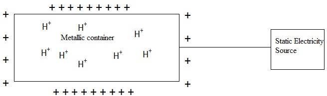

Can you draw a sketch? I think we are having trouble picturing what you want to do (or else what you want to do will not work). Thanks.
That's a very simple representation of what I want. The metallic container is connected to a positive source charge. I just want to know whether the hydrogen inside will also be ionised or not. And if the volume of the container be varied while keeping the amount of hydrogen inside the same, the voltage needed will vary or not.
A situation where all H atoms are ionized would require all the free electrons in the walls to be ionized too or there would be electrons available on the wall to neutralize the H ions.
Do some calculations to estimate the potential to which the box has to be raised to make this work.
Just use Q=CV and the number of atoms in the box X electronic charge. Assume a Capacitance of say 100pF
What happens at the molecular level doesn’t scale to the sizes you suggest.
You might see "coulombic explosion."
  • Haha
No electrons to keep the container together!
