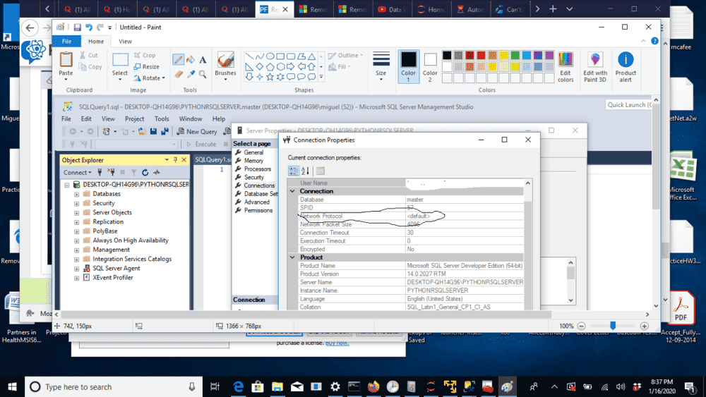

What is shown in the Named Pipes Properties dialog box in MSSM SSMS?
Edit: and what connection string are you using:

The network protocol is set to <default> and options are not enabled:

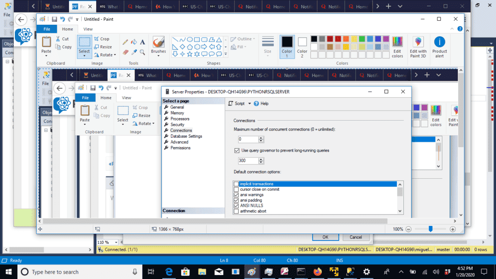

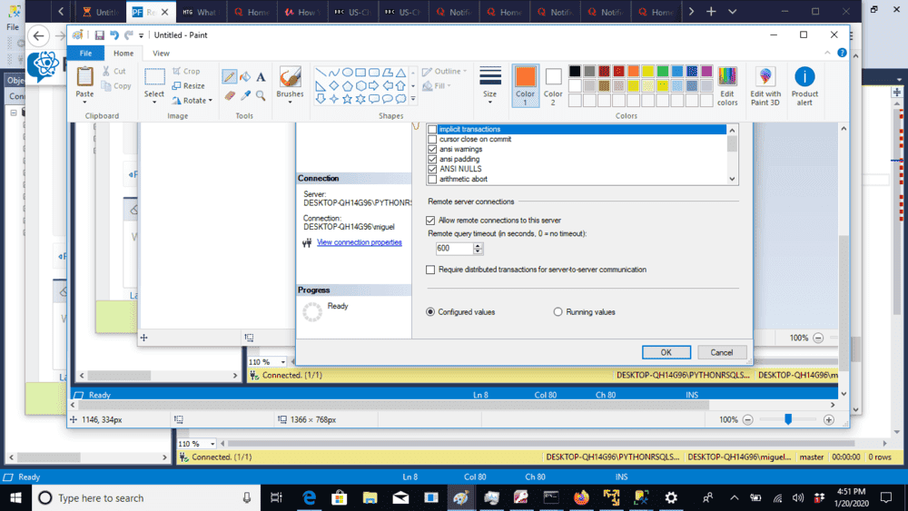

If you can't even access it on the same machine/VM then how are you going to access it remotely? Just to check a couple of things, you are running this console in the same OS instance as the SQL Server, yes? Or are you running the console on a host and the SQL Server instance in a VM - in which case local named pipes won't work? Have you tried accessing via a port i.e. localhost:1433?
Also, I can't see the important setting in the screenshot below:
WWGD said:
... the crucial setting is in the 'Server Properties' dialog box hidden under the 'Connection Properties' box. If you select 'Connections' it should show a list including 'Named Pipes: Enabled', and 'TCP/IP: Enabled' if you want to access via a port (i.e. localhost:1433).
In other words, try all of the following in a console on whatever OS instance is running SQL Server.
