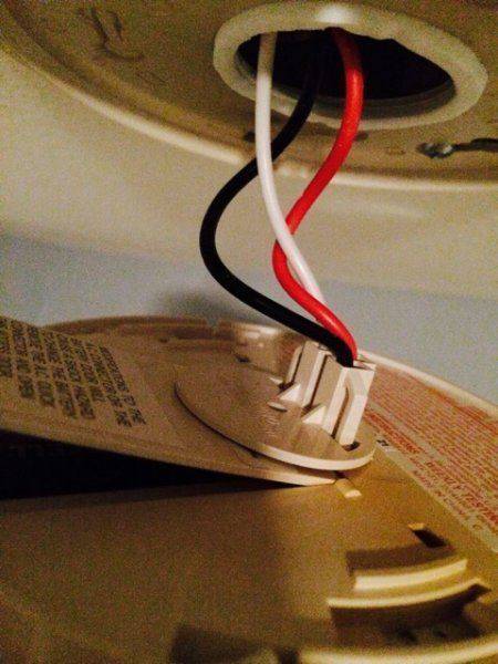

I know I've done this before but for some reason I am stuck. I have a smoke alarm where the battery compartment is being blocked by the permanent power. I can't disconnect or a monitoring alarm will trip (i think?). There is a great deal of tension here and any more force I feel will break the connector. So how do I open the battery area here?

Can you see an indication of the brand and model number - to look on-line for instructions?
Squeeze the sides (clips) of the plug and remove it from the back of the detector. Replace the battery. Reinstall the plug - it should just push in. Reinstall the smoke detector in the ceiling.

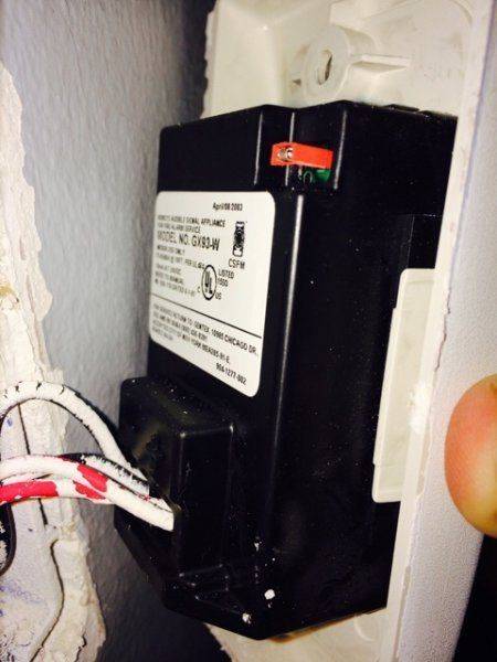

In the detectors yes, but at the moment they are offline. I can't seem to be able to reset this mic.
Kitchen, BR. Bet there's another hiding in a closet, entryway, somewhere.
The mic appears to be powered outside my unit and there is no reset switch

After more thinking I don't think it has anything to do with my detectors. The wall mic is connected to the fire panel downstairs. I think either the mic is broken or something with the panel is setting it off.
What's a "mic"?
[edit]
The model number is readable in your pic: http://www.thesignalsource.com/documents/GX93.pdf

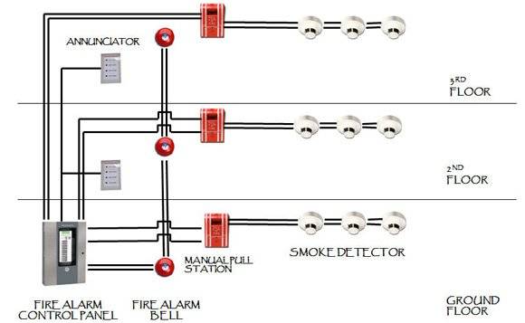

It's a remote horn (speaker) for a building-wide evacuation from the master building alarm panel. It doesn't have a battery backup.

Glad you figured it's involves more than your apartment. e.g.
images compliment of http://attendancesystems.in/fire-alarm-systems.html

If you missed my edit, I found the data sheet for the annunciator -- it doesn't have a battery backup or a "chirp" mode. If it is making noise and it isn't blasting you out of the house, something is wrong with it or the building alarm system.
Since it is just a speaker, it shouldn't ever need to be replaced. There isn't anything in it that can wear out.
