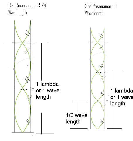

Hello,
My teacher and the textbook seem to be conflicting with each other, and I would like to know who's right. The image on the left was scanned streight out my my textbook, saying that the third resonance is 5/4 lamda. On the right, is an edited version of the textbook image,showing what my teacher had showed me to display the third resonance in an air coloum. He calims that it's 1 lamda. Who's right? or are they both right? Thanks in advance for any help!:-p
http://img428.imageshack.us/img428/9123/resonance8hc.png
bump?:rolleyes:
1/2 lambda or 1/2 wave length is the distance between two succesive nodes or anti-nodes(crests).
so your textbooks shows
1 full wave length + 1/4 of a wave length
so 1 + 1/4 = 5/4 wave length ( or 5/4 lambda)
so it is correct.
your teacher's diagram;
1 full wave length + 3/4 of a wave length = 7/5 wave lenghts (7/4 lambda)
which is actually the 4th resonance. NOT the third!
