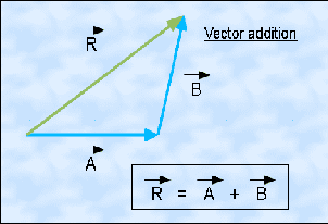

I was adding the vectors using parallelogram.

I don't understand how A + B + R will be zero ? shouldn't it be 2R?
A+B=R. R is the resultant of A and B.
You have three vectors and their resultant is given to be 0. How would you draw this situation using a polygon?

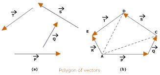

Thank you so much for unambiguous explanations. If there are vectors a, b and c. Then a+b+c using the polygon law, we will get a quadrilateral with four sides as a, b, c and resultant r. If resultant r is 0, then and then only we will get a triangle after addition. Similarly if four vectors are given & their resultant is zero they will form quadrilateral with four sides otherwise quadrilateral with five sides, fifth side being the resultant. Right?
With five sides, it becomes a pentagon.

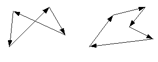

Only if all the vectors have the same magnitude can a regular figure (square, pentagon, hexagon,...) result. That's generally not the case. Further, when you go beyond three vectors there's no guarantee that the vector path won't cross itself or have concavities:
So irregular polygons can be formed (as on the right in the figure above) but so can objects that aren't polygons at all.
The case of three vectors that form a closed loop will always result in a triangle.
