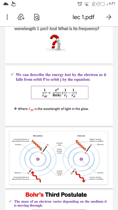

Hi curious people
Today i had a lecture about bohr model of the atom .we know that the total energy of electron in orbit is minus e squared divided by 8 pi times epsilon times R of the orbit . this is written in my book and i agree with this .But when the author writes a formula for an emitted photon he writes the difference of the law mentioned above but without epsilon . why ?
Thankes

This is a picture from the book

I have no idea what units the equation you posted is supposed to be in. There's a missing electron mass, for one thing.
No, it's not missing. This formula is in terms of the ##n^{th}## Bohr radius ##r_n##, which is given by:
##r_n = \dfrac{n^2 \hbar^2}{Z e^2 m_e}##
(where ##Z## is the number of protons in the nucleus, and ##m_e## is the mass of the electron)
The answer to the original poster's question is that they are using units where ##\epsilon_0 = 1##.
Ah...it's buried in the r's. I see,
stevendaryl said:
he answer to the original poster's question is that they are using units where .
Are you sure? Isn't it buried in the r's as well?
No ...i think it is missing
We always us SI in my institute
