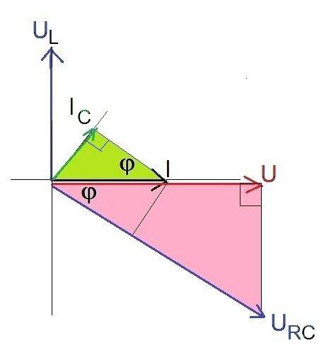

Hi, sorry I wasn't active, I decided to practice these kind of problems more (easier problems) and then try to solve this one. I got by drawing vector diagram that:
and ##U_C## vector has angle ##\sin \phi= \frac{-U_L}{U_C} \rightarrow \sin \phi = -\frac{2}{3}##.
And ## \sin | \phi| = \frac{I_C}{I}## so ##\frac{I }{I_C} = \frac{3}{2} ##
Then ## \frac{X_C}{X_L}= \frac{I}{I_C} \cdot \frac{U_C}{U_L} = \frac{9}{4}=2.25##
Is this correct?
It is correct, and a very nice short solution. Congratulation! I prefer using complex impedances instead of vector diagrams, but my solution was very long and complicated.

To make the solution more clear, I add the phasor diagram. Because of resonance, the generator voltage U is in phas with the generator current I.
