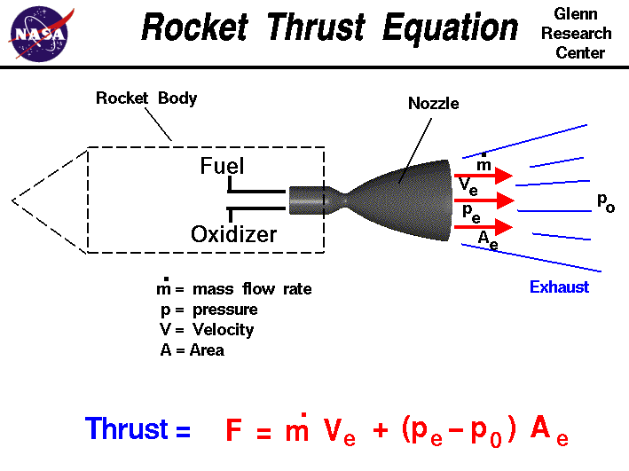

What is velocity V in mass flow rate formula, velocity of inlet ,outlet, velocity of rocket speed in relation to freestream?
V is just velocity in the generalized force equation. Inlet and outlet velocity are clearly labeled, and the rocket is at rest always under this equation (velocity of the gases is measured relative to the engine)..

I am trying to calculate rocket thrust, but what V I must plug in in mass flow formula if I have just label Vo and Ve????
I want to say that mass flow rate at exit depend on Ve, on input depend on Vo
Ok, the original equation is for jets. Rockets don't have initial gas velocity, so you zero that out and just calculate from exit velocity.

user079622 said:
Second thing, I dont understand part (pe-po)A, this is just force express through pressure times surface, that part must be equal as mdot x v..
dont make sense formula has part of pressure contribution and momentum mdotxv contribution to thrust
Again, that equation is for a jet (or fan), where there may be a pressure change through the jet.

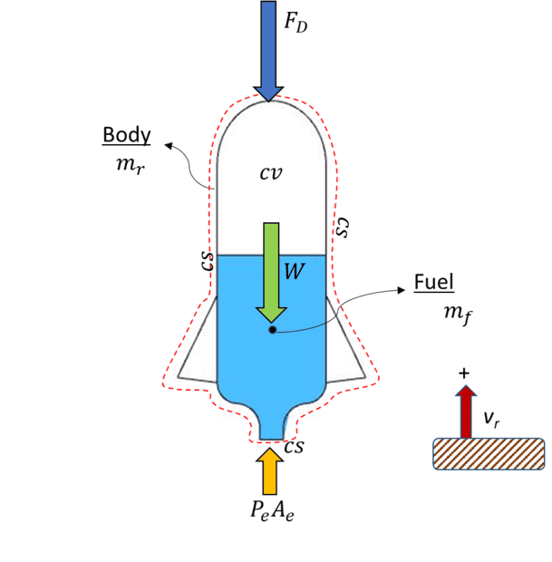

It makes sense in the context of Newtons Second Law for control volumes " a.k.a. "The Momentum Equation" in fluid mechanics. A control volume surrounds the rocket, slicing through the exhaust jet.
$$ \sum \boldsymbol F = \frac{d}{dt}\int_{cv} \boldsymbol v \rho ~dV\llap{-} + \int_{cs} \boldsymbol v \rho \boldsymbol V \cdot d \boldsymbol A \tag{1}$$
Turing your rocket vertical:
The LHS side of ##(1)## is the sum of the external forces acting on the control volume, Drag, Weight, Gage Exhaust Pressure. The rest comes from evaluating the RHS under certain simplifying assumptions.

user079622 said:
This integration get same result as (pe-po)Ae?
Its a simplification. Uniform pressure distribution. In the diagram I showed the force as the effect of a uniformly distributed pressure integrated over ##A_e##... i.e. ##P_e A_e##

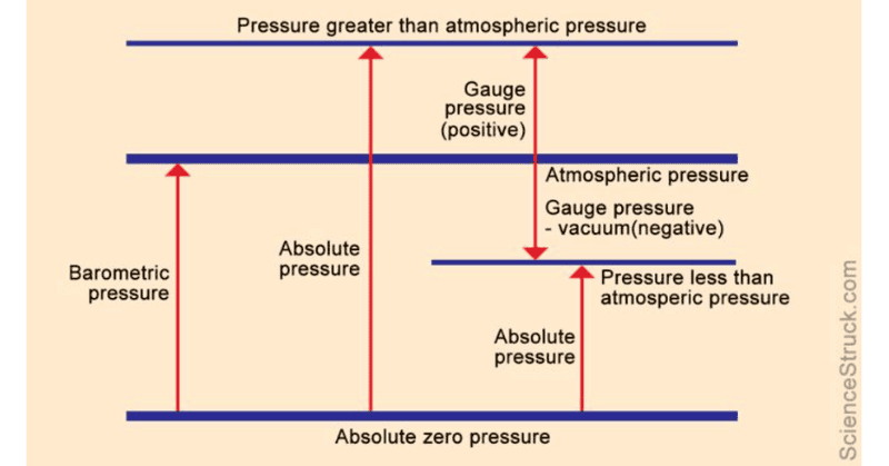

Note that the symbols are used differently. Your ##p_e## is an absolute pressure, mine (##P_e##) is a gage pressure, but the main idea is the same.
In practice the goal is to maximize thrust, and believe it or not... the pressure term exists, but it is actually a detriment to the thrust, because there is a dependency of the exhaust velocity ##V_e## on the nozzle exit pressure ##P_e##, and in optimization they try to make ##P_e## as close to ambient pressure as possible ( bringing the pressure term to zero) to maximize ##V_e##.
My (pe-po) is your gage pressure Pe.
So if you just integrate gage pressure over nozzle area ,like you said, that you still missing part mass flow x v ? so your post #12 is not correct?
