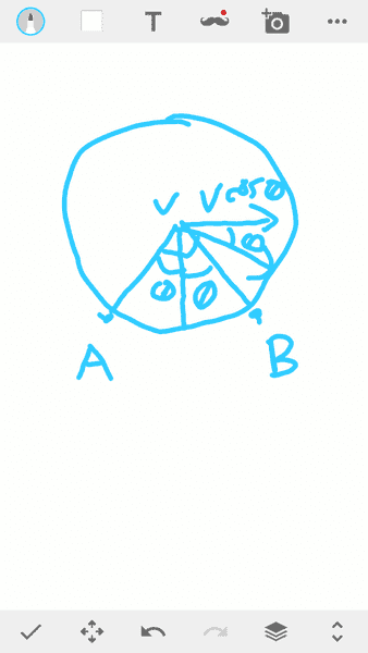

Draw a diagram. Label the bar it was just rolling on A, the bar it is about to hit B, the centre of the cylinder O.
I defined theta as half of the angle AOB.
Draw the velocity direction vector from O. This is normal to AO. For the angular momentum about B you want the component of the velocity that is normal to OB. What is the angle between those two normals?
Here is the image
Carbon123 said:
Here is the image
You are showing v cos(θ) as the horizontal component, which is correct, but not what is wanted. For the angular momentum about B we need the component normal to OB.
So that would mean Wrcos2Θ
Right.
So what is the total angular momentum about B just before impact?
If just after the impact it has angular velocity w' about B, what is its angular momentum in terms of that?
MωRcos2Θ×R is angular momentum around point B .angular momentum after is going to be Mω'R×R ?
