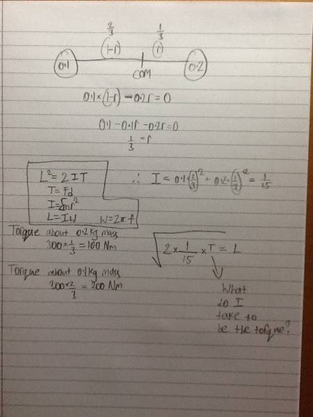

Rotating diatomic - Pretty basic first year question. Workings given

Part v is where I'm stuck.
All relevant equations and the bit where I'm stuck are in the second attachment with my workings
If I can find the value for L I can substitute it into the equation for L=Iw and using the known I value I can calculate w and hence the frequency (2pif=w).
tiny-tim said:
hi elemis! :smile:
Why are you making it so complicated?
finding ω is a straightforward centripetal acceleration question! :wink:​
i goooot itt ! Woooohoooooo ! Thank you !
