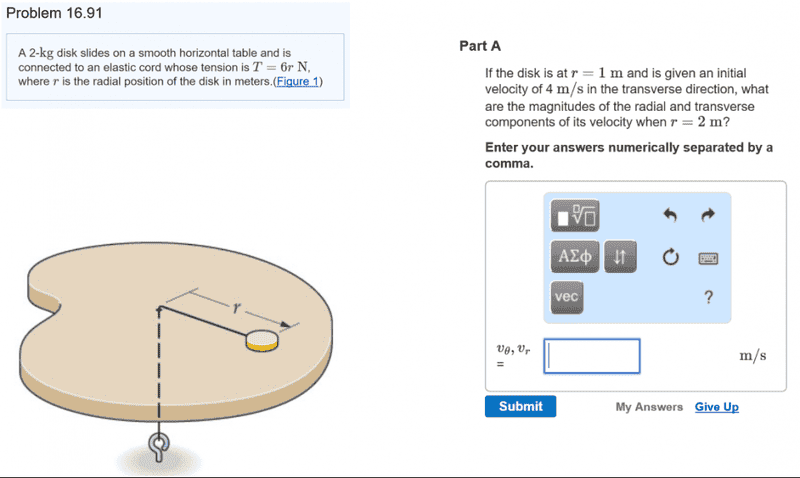

Rotating disk find the radial and transverse velocity
6 replies · 2K views · last reply
nysnacc
184
Online homework screenshot, Problem 16.91: a 2-kg disk on a smooth horizontal table tied by an elastic cord to a central hole, with radial distance r marked; Part A asks for radial and transverse velocity components at r = 2 m.
rXF ??
T= 6 N (r =1)
T = 12 N (r=2)

There is a lot going on in this problem and we have to make some (hopefully correct o_O assumptions).
First the disk is spinning about the centre at 1 meter with a tangential speed of 4 m/s.
Then it motions out to 2 meter and they want both the radial and tangential speed when it is spinning about the centre at this distance.
What comes to mind is maybe trying energy conservation?
Energy is stored in the elastic as it is stretched, thankfully it obeys Hooke's law!
Also the tensions at the various radii supplies the centripetal forces for the spinning motion.

I mean what does those contribute to the finding of v?
Can I just use F= m V2 / r which i put F = T at 0.25m, and r = 0.25m ... so that V is the Vtheta??

Conserving mechanical energy is a good starting point and gives you one equation. You need to find two quantities so you need a second equation. What else is conserved? Hint: The force on the mass is along the radius.

mv^2/r is the centripetal force needed to keep the disk in circular motion... what could be providing the centripetal force, and does it provide that much?
Note: the other two are jumping ahead. You need to understand the motion before deciding on what laws to use, and what assumptions are valid.
Nysnac's assumptions may not be valid, and how kuruman's modification works will depend on that.
So let's start with understanding the physics...
... post #2 asks a bunch of questions, please answer them.

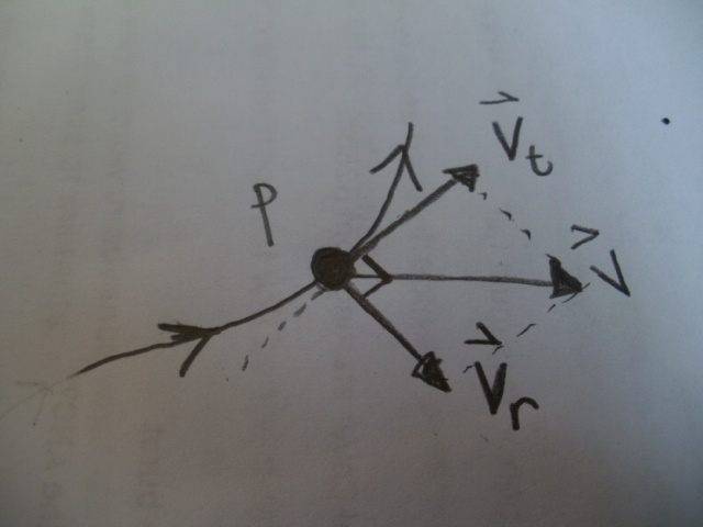

When an object, p, moves along a curved path its velocity v can be broken into two components, a radial component vr and a tangential component vt
Hand-drawn vector diagram: a dot labelled P with a curved path entering from the lower left, velocity arrow v to the right, and its components v_t (transverse) upward-right and v_r (radial) downward-right, drawn as dashed-line parallelogram.
