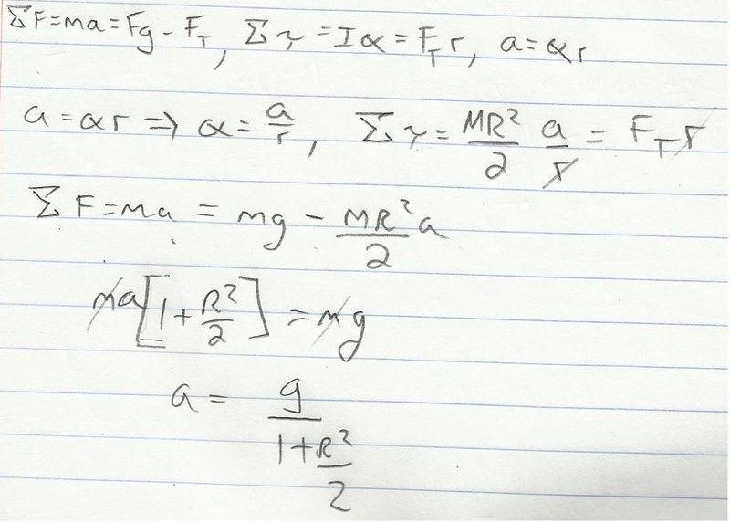

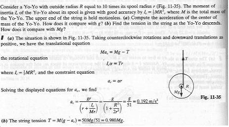

Please see the attachment.
Please see the attachment. When I tried to solve the equations for a I got a different answer and I don't see what I'm doing wrong. Please let me know if you cannot follow my work. Thanks for any help you can provide.

Illegal algebra cancellation.
\frac{MR^2}{2}\frac{a}{r}=(F_T)\,r
In the above equation, you canceled r on the left side with r on the right side.
oh that's embarrassing thanks
