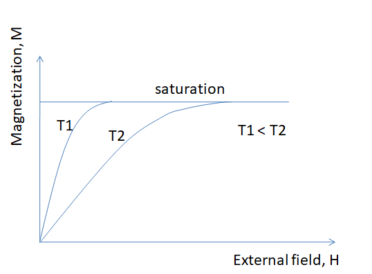

Can i try to summarize with a picture?
So, the saturation is always the same, but the higher the temperature is, the higher the field needed to reach it; then, at a given external field, the same material can be at saturation at a certain temperature but can be not at saturation at an higher temperature.
The curve does not show the tremendously dramatic change that occurs at the Curie temperature (below the Curie temperature, the susceptibility is much higher), but otherwise, I think it has the right idea. Also, be sure and see my post 8 including a couple additions to it.
Yup, so the slope of T1, T2 etc is the permeability of the material, if you plotted this value over a wide range of temp above and below the currie temp, it would be high below the currie temp, and nose dive to barely above u0, which is the dramatic effect Charles Link is referring too.
I forgot to tell that the picture was depicting the situation below the curie point.
