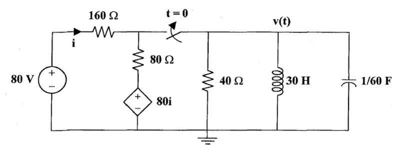

Find v(t) for all t>0. Use second order method.
Before the switch is closed:
solving for i:
-80+160i+80i+80i=0
i=0.25A
KCL:
From node v(t):
[C dv(t)/dt] + i(t) + [V(t)/4] + [(v(t)-80i)/80]+[(v(t)-80)/160] = 0
KVL:
v(t)=L di(t)/dt
Later on solve the 1st equation for i(t), then substitute into KVL equation.

Consider replacing everything before the switch with a Norton equivalent.
Have you learned about Laplace transforms yet?
yes, but the question ask us to use 2nd order to solve it.
Do we need to take in account for the dependent source?
we convert it to 80*0.25=20V
In my opinion, I don't think that using Laplace transforms to solve the differential equation would be cheating...
Yes, the dependent source makes a difference, but you may be surprised by the resulting Norton equivalent. The Norton equivalent should have a current source in parallel with a resistance; 20V is not a current (nor is the the correct Thevenin voltage).
