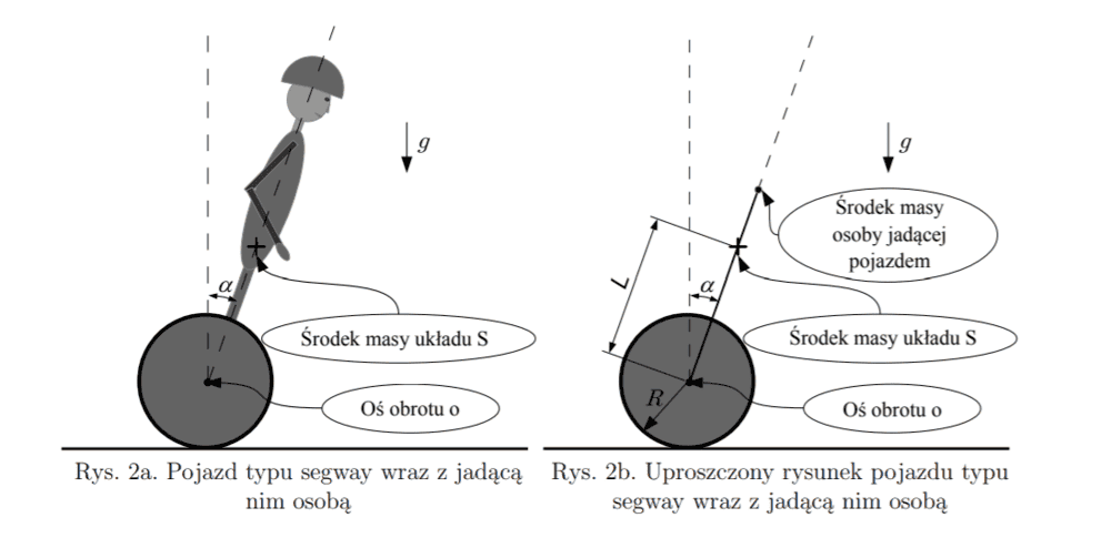

The thing is , I am obliged to solve a segway problem, which accelerates linearly along frictionless plane. The rider is treated as massles rod with the point mass at its end and I am wondering what is condition that rider does not fall.

Okay, here is the thing, the rider accelerates on segway. He leans forward making angle alpha with respect to vertical axes. I know the moment of inertia of axe, wheels and engine combined. I know radius of wheels. The rider might be treated as massless rod with point mass at its end. I know the center of mass of the system and mass of the rider and segway combined. I should omit air resistance and friction. My task is to derive equation of acceleration.

Yes I mean rolling friction :). The picture is in polish, so I will translate it. The diagram on the left shows the segway with rider. The one on the right shows the simplification of rider as massless rod attached to segway with point mass at its end.
"środek masy układu"- center of mass of the system
"oś obrotu o"- axis of rotation of wheels named "o"
"śodek masy osoby jadącej pojazdem"- center of mass of person riding the segway

In the picture I attached- no, the task is to derive the equation of linear acceleration knowing: M-mass of the person and segway combined, I-moment of inertia of wheels combined, a-angle between vertical line and peson, L the distance of center of mass from the axe of wheel's rotation, R-radius of wheel.

The torque applied to the center of mass due to gravity is equal to
T=M*g*sin(a)*L
The only force which could balance the torque might be inertial force due to accelerating wheels.
Fb=-MA
A-acceleration
cos(a)*Fb*L+T=0
M*g*sin(a)*L - cos(a)*M*A*L=0
A=g*tan(a)
For me it is suspicious and seems to simple. What went wrong?

Wasn't there a difference between the centre of mass of the man and the centre of mass of the system?

Also, I have to guess what ##M, L## are. You don't say what these variables mean.
They were stated above- L is the distance of center of mass of the system from the axis of rotation of wheels, M is the mass of person and segway combined.
PS wasn't there a complication that you have to take the motion of the wheels into account? The applied force doesn't only generate linear KE but rotational KE of the wheels?

Why are you using ##M## for the torque? It's only the man who is leaning over.

I think you have ignored all the complicating factors.
so I should take into account that the center of mass of the man is leaning over and the center of mass of the system is accelerating linearly?
Yes, you need ##m## for the mass of the man; the height of the axle (I assume this is the radius of the wheels); the mass and moment of inertia of the wheels.

I've had a proper look at this. Assuming the man is balanced on an axle, then the kinetics of the wheels may be irrelevant. Unless you need to look at contact forces.
If you just want the acceleration of the system, then that must be equal to the acceleration of the man. So, you can simply look at the forces on the man.
That reduces to your answer, although your calculation to get there might not have been quite right!
