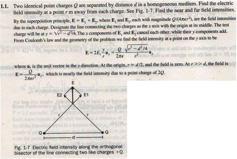

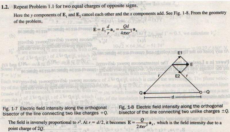

I'm just trying to show that the equation in the attached image becomes E = Q/(2π ##ϵ_0## ##r^2##) * ##i^##, where ##i^## is i-hat, the unit vector for when r is the smallest that it could be, which is when r = d/2.
I'm doing this with reference to problem 1.2 (and I'm including problem 1.1 so that you have the background information for problem 1.2).
The equation in the image as well as E = Q/(2π ##ϵ_0## ##r^2##) * ##i^##.
My attempt is attached as MyAttempt.pdf.
Is it a coincidence that I'm getting double the value shown in problem 1.2?
Any help in getting to show that the vector equation for the electric field of a dipole breaks down to E = Q/(2π ##ϵ_0## ##r^2##) * ##i^## would be greatly appreciated!

You are approaching this well, but is easier to why this result comes if you examine it like this.
The x-components of the electric field add, so we say that,
E_t = E_1 + E_2\\<br /> E_1 = \frac{1}{4\pi\epsilon_o}\frac{Q}{r^2}sin\theta
Which is the same as E_2 because both value of sines are positive. Even though we have a specific value for what r should be, to justify our solution we will define r using the Pythagorean theorem. So the total electric field then becomes.
E_t = \frac{2}{4\pi\epsilon_o}\frac{Q}{y^2 + \frac{d}{2}}sin\theta\\<br /> sin\theta = \frac{d}{2}{r}\\<br /> E_t =\frac{1}{4\pi\epsilon_o}\frac{Qd}{r^3}\\<br /> E_t = \frac{Qd}{4\pi\epsilon_o}\frac{8}{d^3}\\<br /> E_t = \frac{Q}{2\pi\epsilon_od^2}
Then remember that your d value is actually
d^2 = \frac{d^2}{4} = r^2
This should give you the answer that you are searching for.
Thanks for your answer.
Isn't what I got in the PDF of my work (in my opening/first post of this thread) ##E_t##?
It seems that you made a few typos, so in an attempt to overlook the typos, I think your work results in ##E_t## = Q/(2π ##ϵ_0## ##r^2##), such that ##E_1## = ##E_2## = Q/(4π ##ϵ_0## ##r^2##).
I'm mentioning this because my ##E_t## seems to be double yours (which in turn is double ##E_1## and ##E_2##, respectively – such that my ##E_t## is four times ##E_1## and ##E_2##, respectively), so while I think I see what you're trying to say, I'm still not getting the algebra to confirm it.
Could you please elaborate on this situation?
