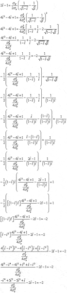

Show that t-hat = 1/2 solves the equation below.
Now, I know I can just plug in 1/2, where t-hat is, and see that both sides are equal to zero, but is it possible to isolate t-hat. Say, if wanted to find t, and did not know the value already..?
<br /> \[2\hat t - 1 = \frac{{\sigma _F^{}}}{{2\sigma _z^{}}}\left( {\frac{1}{{\sqrt {1 - \hat t} }} - \frac{1}{{\sqrt {\hat t} }}} \right)\]<br />
<br /> \[\hat t \in [0,1]\]<br />
<br /> \[\begin{array}{l}<br /> z \sim N\left( {0,\sigma _z^2} \right)\\<br /> F \sim N\left( {\bar F,\sigma _F^2} \right)<br /> \end{array}\]<br />
<br /> \[\begin{array}{l}<br /> 2\hat t - 1 = \frac{{\sigma _F^{}}}{{2\sigma _z^{}}}\left( {\frac{1}{{\sqrt {1 - \hat t} }} - \frac{1}{{\sqrt {\hat t} }}} \right)\\<br /> 4{{\hat t}^2} - 4\hat t + 1 = \frac{{\sigma _F^2}}{{4\sigma _z^2}}{\left( {\frac{1}{{\sqrt {1 - \hat t} }} - \frac{1}{{\sqrt {\hat t} }}} \right)^2}\\<br /> 4{{\hat t}^2} - 4\hat t + 1 = \frac{{\sigma _F^2}}{{4\sigma _z^2}}\left[ {\frac{1}{{1 - \hat t}} + \frac{1}{{\hat t}} - 2\frac{1}{{\sqrt {1 - \hat t} \sqrt {\hat t} }}} \right]<br /> \end{array}\]<br />
Thx, any help is appreciated, P DK
From your last line, isolate the square root term and square both side...get rid of those square root signs.
Hi Berko
Thanks for your reply
I have tried the following, but I have no clue whether it is getting me in the right direction.
Your seventh line of work...you squared the right side but not the left.
Your ninth line of work...one of your minus signs should be a plus sign.
Fix those and redo. I'll look at what you come up with.
