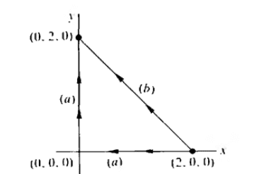

Calculate the work done by a force, against an electric field, to bring a charged particle (2 coulomb) from the point (2,0,0) to (0,0,0). Also calculate the work from (0,0,0) to (0,2,0).
Finally calculate the work done going directly from (2,0,0) to (0,2,0) and compare both results.
The field is E= (2x, -4y)
dW= - q F dr
The only trouble I have is with the signs.
I got 24 Joule in the last part, and -8 and 16 in the first two. I guess the -8 is wrong and it should be 8, so the sum is 24, as it should be in a conservative field.

Here I think the differential of length is -dx, not dx, that is causing all the trouble.
W= - (+2) * ∫ 2x * (-dx)= 4 * ∫x dx = 4 (x2/2) and this must be evaluated from 2, lower limit, to 0 upper limit. So I get:
4 ( 0 - 4/2) = -8
According to the book, the Work is:
W=-2 ∫2x * dx ,
So he gets:
+ 8 Joules.
CLearly he is using a differential of length positive, but x goes from 2 to 0, clearly from right to left, and clearly is just the opposite of the field that is 2x, which means is positive.
So what I am doing wrong?
In the work formula there is always a minus to show the applied force is opposite to the field, so once you have introduced that minus sign at the start of the formula, you don't need to specify in which direction the differential of length goes?
You need to be consistent with assignments of positive directions. When you write that the work is ∫F.dx you are assuming the F and dx are being taken as positive in the same direction. The force is F, not -F, and the infinitesimal displacement is dx, not -dx. Each of those might take a negative value, but that's another matter. E.g. If the integration range is 1 to 0 then the dx's will be negative.

Differential work dW done by the (externally applied) force F is F⋅ds = -qE⋅ds = -2(2x)(-dx) = 4x dx.
dx is by definition positive. It's a magnitude. If you want to go negative it's -dx as I've done above. If I write "-2" the "2" is still positive.
So it's W = Σ(4x dx) = ∫4x dx from 0 to 2, not 2 to 0, = +8.
My best answer is the above: -qE⋅ds = -2(2x)(-dx) = 4x dx, dx > 0 always.
Nice thing about physics is that usually common sense tells you the sign! Keep that in mind and be careful with the grammar. For example, distinguish between work done by an E field vs. work done by an external force against an E field, etc.

You can integrate from 2 to 0 but then you have to integrate -2(2x)(dx) = -4∫xdx from 2 to 0 = +8 again.
dx is always +; the necessary sign is provided by the limits of integration going from 2 to 0 instead of the other way around.
No, you don't.
rude man said:
dx is always +
No, it isn't.
If I integrate ∫x=01x.dx I get 1/2. If I integrate ∫x=10x.dx I get -1/2. It is unnecessary to turn the second into - ∫x=01x.dx or Into -∫x=10x.|dx|.

You don't need to do anything special according to the direction of the force or route of the path.
##W = \int_S\vec F.\vec {ds}##
If we ignore mass and/or acceleration:
##\vec F = -q\vec E##
##W = -q\int_S\vec E.\vec {ds}##
In the present problem, the first leg is from (2,0,0) to (0,0,0):
##W_1 = -q\int_{x=2}^0 E_x.dx = q\int_{x=0}^2 E_x.dx##

I find really weird seeing that E is pointing to the right in the x axis, the path is pointing to the left and you don't get an extra minus sign when you multiply them.
Since those two quantities are vectors they have a magnitude, but they also have a direction. ds for me is equal to -dx i.
Being i the unit vector in the positive x axis.
If you write E and ds explicitly you have:
E= (2x,...)
ds= (-dx,...)
That is basic geometry, if you multiply them you get an extra minus sign.
In other words, I would understand what you just wrote if the x-axis were positive to the left, and negative to the right of the point (2,0,0), but that is not the case. Maybe I should go to bed and tomorrow look for it.
I assume you mean ##\vec{ds}=-\vec i dx##. (ds typically stands for ##|\vec {ds}|##.)
If so, that is wrong. By definition, ##\vec {ds} = (dx, dy, ...) = \vec i dx+\vec j dy+...##.
dx is an increase in x. If the path is going right to left then that increase is negative, i.e. dx takes a negative value.
Yes, I meant that.
Now it is clear. Thanks!
