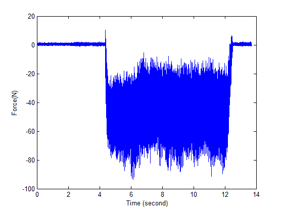

Hi ,
The problem is how to analysis this signal in terms of time segments to understnd the characteristics/pattern of this signal
There is no relevant equtions
I have tried to use :
RMS
Wavlet
FFT
But which one of them can give us a better understing of the system,
Thanks,
Your problem statement is fairly unconstrained so--
For frequency analysis, consider making a spectrogram, a 3 dimensional graph (frequency vs amplitude vs time).
For amplitude analysis, experiment with various moving average (RMS) plots.
Presumably you have a data set that corresponds to the graph, and not just the graph alone? You might want to investigate the use of the Lomb-Scargle Periodogram method to tease out the underlying frequency components of the signal.

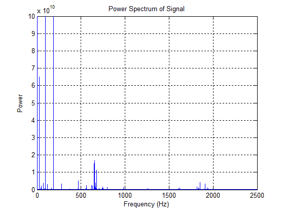

Well, I have applied frequency domain
Matlab code:
m=fft(x)
n=length(x)
power=abs(m(1:floor(n/2))).^2
nyquist=1/2
freq=((1:n/2)/(n/2)*nyquist)*5000
figure
plot(freq,power)
xlabel('Frequency (Hz)')
ylabel('Power')
title('Power Spectrum of Signal')
grid on
amp=abs(m(1:floor(n/2)))
figure
plot(freq,amp)
ylabel('Amplitude')
title('Amplitude Spectrum of Signal')
grid on
But I am not quite sure which one of them is best/correct,any suggestion,
