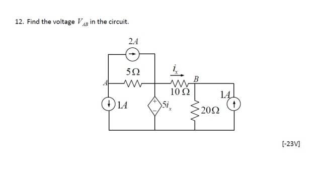

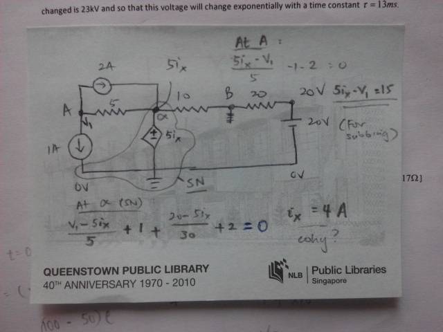

I did a source conversion on the right-most 1A current source to get a voltage source to work with for this question. However, when I tried to work out the solution, my values seem wrong, but I don't understand why, especially for the part where I had ix = 4A. May I know where is my mistake? Thank you! :D
(Pardon for the poor image. If it cannot be seen clearly, feel free to ask me to another shot. :) )
My solution (partial, stuck):
When you did your conversion, point B shouldn't be connected to ground, it wasn't in the original problem before the conversion.
Oh, Point B isn't connected to the ground. I accidentally drew a stray line there and the zig-zag things were meant to 'cancel' the stray line. Sorry. :X
Oh ok let me look through this again.

The value for I_x doesn't seem to be correct. I'm not exactly sure how you got the value that you did. The node to the left of the 5 ohm resistor there's only three paths for current to flow through. It looks like your summing the currents at node A when you solve for Ix? If this is the case there shouldn't be four currents.
Yupp, my value of ix is wrong but I don't know why. ><
Yup, I only handled 3 branches for A, which I got this equation:
(5ix - v1/5) - 1 - 2 = 0
You have made the same mistake as you did with an earlier circuit analysis. When you lasso a block of any circuit and say the sum of currents into that block = 0, you must include all currents in all wires cut. Here, your lasso is cutting across 5 wires, so you should account for those 5 currents. You have a current (5 Ix - 20)/30 leaving the top, but you also need to show it reentering at the bottom on the Earth wire. (If you were to erase one of your Earth wires, that current would join with the current in the other Earth wire so you'd still need to account for it.)
When you do it correctly you'll get the equation you already have using Σ currents to an ordinary node. So your SN idea achieves nothing additional.

Galaxy_twirl, you really should forget about making the reference node into a supernode and writing a node equation for it. It's almost never a profitable approach and just leads to more work for little benefit.
A reference node is usually chosen because it has the most common connections. Since you do not have to write the node equation for the reference node, this eliminates having to deal with the most complicated equation pertaining to the circuit.
In your circuit with the 1 A source converted to its Thevenin equivalent, you have ##i_x## running between two nodes of "fixed" potentials (with respect to the reference node). One is ##5i_x## and the other 20 V. You know the values of the resistors in between. So just write the equation for that current.
I see.. Hmm. Does it then mean that, assume currents entering the supernode is -ve, while currents leaving the node is +ve, I will have: (5 Ix - 20)/30 - (5 Ix - 20)/30? And is this why you said that my SN achieves nothing additional?
I see. I think that was what my friend did, so in the end, I had:
##5i_x - 20##/##(20+10) = 0##
##i_x = -0.8A##
