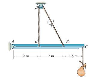

Simple quesiton involving Tension of a cable supporting a beam

Determine the tension in the cord if the weight is 90kg
The tension is the same throughout the rope apparently so;
∑Ma=0
= T(2) - (4/5)T(4) - 882.9N(5.5)
T= 933.383N...
would that be the force in the cable then? i don't have to worry about Ay or Ax because that is my pivot point then right?
Yes, you choose A as the point to take moments about precisely because you don't want to be bothered with the reaction forces at A. :smile:
∑Ma=0
T= 933.383N...
erm … why is one T minus? :redface:
