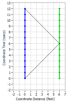

You are describing the process by which a Laser Rangefinder measures length and nowadays, that is more in line with the definition of the unit of length. Here is a spacetime diagram depicting the measurement of an object whose length measures to be 6 feet. The blue line represents the laser rangefinder with dots marking off 1-nanosecond increments of Proper Time and the green line represents the target at the far end of the object. The thin black line shows the path of the laser pulse:
Note that I am assuming the speed of light to be 1 foot per nanosecond so the time it takes for the light to progress from one end of the object to the other and back is 12 nanoseconds. That number is the only thing that matters for a laser rangefinder to determine that the length is 6 feet by applying your formula.
Note also that your term "T" refers to the Proper Time of the clock in the laser rangefinder. We can apply your formula T'=γT to mean that T' is the Coordinate Time and we see that since v=0, γ=1 and so T'=T=12 nsecs in this example. The light propagates according to the Coordinate Time, not according to the Proper Time.

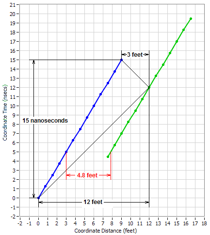

The time that you are describing, T', is the Coordinate Time in this new frame. The Proper Time of the laser rangefinder is still T. This is describing the Time Dilation of the clock in the laser rangefinder as shown in this diagram transformed from the first one to a speed of 0.6c:
As you can see, the dots marking off the Proper Time of the laser rangefinder are stretched out (dilated) so that it takes longer in this frame for the clock to reach 12 nanoseconds. Your formula tells us by how much: T'=γT. Since v is 0.6c, γ=1.25 so T'=1.25*12=15 nanoseconds. And as you can see the total path length for the light is 15 feet which takes 15 nanoseconds. Note also that the length of the object is contracted at this speed so that the light takes the right amount of time to make its trip but the observer operating the laser rangefinder has no awareness of either the Contracted Length of the object or of the time it takes for the light to hit the target or of the round-trip time it takes for the light to propagate. As I stated before, the laser rangefinder only knows of the Proper Time of its own clock and so establishes the length of the object to be 6 feet, just as in its rest frame.
Does this all make sense to you? Any questions?
